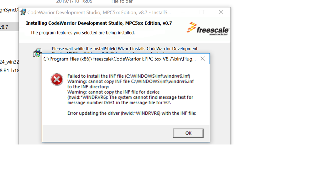

codewarrior install failure in windrvr6.inf with win10

Hi Snow Chen,
You use CodeWarrior for MPC5xx.
This version of CodeWarrior is NXP legacy product, it only supports Windows 2000, Windows XP/Vista (32-bit)
So the error message you met is normal. Please use our recommended system instead.
For more information, see
CodeWarrior® Development Tools for MPC5xx|NXP
