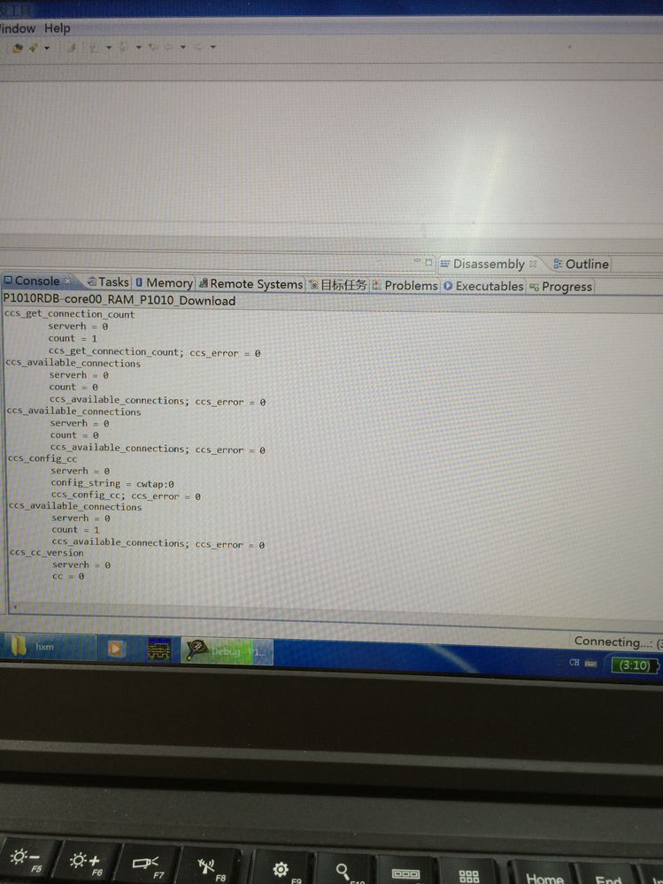

Hello, i am now meet a problem when i use the codewarrior tap to flash uboot to the p1010 board.The codewarrior tap is newly buyed,the chip i used is p1010,the codewarrior software version is 10.4,i am not sure it is the software problem.When i download it ,the software shows "Resources unavailable".can you help me to solve the problem?thank you very much!

Hello hxm h,
Please check whether the license is valid.
Please capture CCS log in CodeWarrior IDE, and attach CCS log here.
First please create a bare board project following CodeWarrior new project wizards.
Before connect to the target, please enable CCS log from "Run->Debug Configurations-><project>-core0_RAM_<processor>-Connect(Download)->Edit...->Advanced->Advanced CCS setting->Enable logging", and connect to the target from "Run->Debug Configurations-><project>-core0_RAM_<processor>-Connect(Download)->Debug”, the CCS log will be printed in the console panel in CodeWarrior IDE.
Please open the console panel from Window->Show View->Console, and if nothing displayed, please choose the correct session on the right top icon in the panel.
If the CCS log in the console is truncated, please enlarge the console buffer from Window->Preferences->Run/Debug->Console->uncheck "Limit console output".

Hello,YiPing Wang:
Thank you for your answer.But the question is still not be solved.The codewarrior I am now using is version 10.5 evaluation,the license is valid.The pics below show the configuration and ccs logs.Can you help me to resolve the problem? Thank you very much!

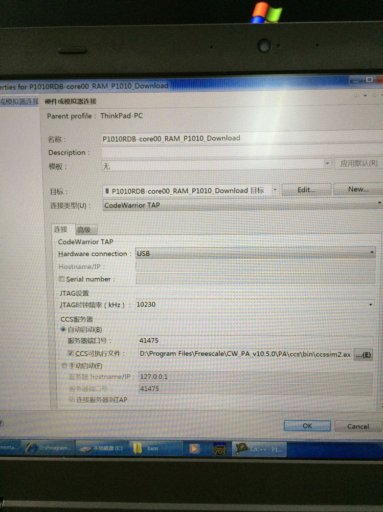

addiyi
Make sure you select the correct tap type in Debug Configuration -> Connection type.

hxmh
Hello,thank you for your answer.But the question is still not be solved.The codewarrior i am now using is version 10.5 evaluation,the license is valid.The pics below show the configuration and ccs logs.Can you help me to resolve the problem? Thank you very much.2.JPG

yipingwang
Hello hxm h,
In the connection panel, please don't select "CCS 可执行文件“,you are specifying a simulator path to CodeWarrior CCS, that's incorrect, please keep it empty.
Yiping

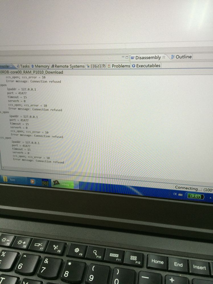

hxmh
Hello,Yiping,
I have done the procedure you have told me to do,but the problem is still.The pics show the codewarrior i am using and the errors i am meeting.The goal I want to get is flashing uboot to P1010,can you tell me all the procedures that i need flow ? Thank you!
