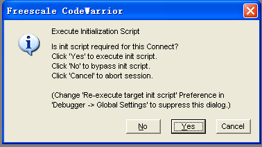

When Codewarrior is connecting the target board, the following information merges. What's its meaning?

yipingwang
Hello Min,
If your target board is set to boot_high you need to use CodeWarrior initialization file 8250_AM_Rattler_init_high.cfg, otherwise please use the file 8250_AM_Rattler_init.cfg.
According to your CCS log, it seems that your target board configuration is not coincident with CW initialization file.
