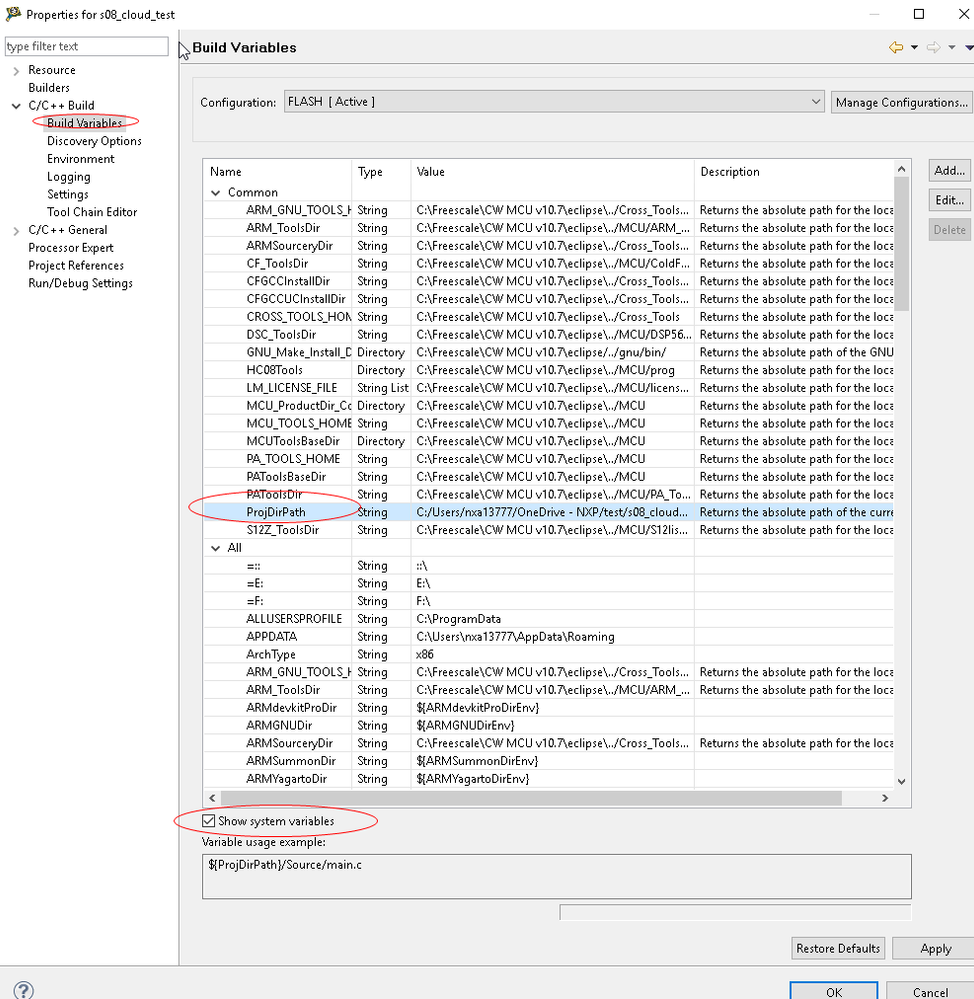

How do I access projects that are stored on my cloud drive. CW does not see the cloud drive, but Windows does. It was fine with CW10.7, but not with CW 11. Now it does not work with either
1,930 Views

I installed CW 10.7 on a new machine and it can see everything on my cloud drive (Dropbox). However :-
I imported my project into a new workspace (without the "copy files into the workspace" option. It imported OK and I can see, edit and compile my source files. When I do a build I get several errors;
"FATAL C50: Input file 'Sources/Events.args' not found"
There are similar errors for "main", "events" and two of the Processor Expert components, but all of the files are there in the project and I can see their content in the editor window.
Why doesn't CW like me???????

Hello Julian,
Sorry I haven't use the Dropbox, while I'm glad to talking with you about this issure.
Please check the input path :
also check the "Build Variables":
And could you please take a screenshot to  tell me when import the project in cloud , how to choose it? I want to test on my side to check the issure.
