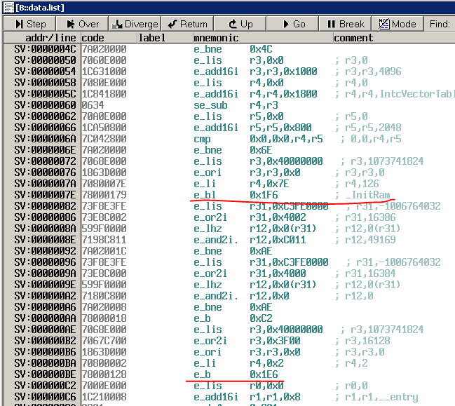

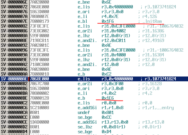

I have a problem about assembler code interpret.
In .s file, if I use  " bl _InitRam " to jump into _InitRam, the code is translated to "e_bl 0x1F6", this is right.
But if I use "bne  init_sram_noinit" to jump into init_sram_noinit first, and in init_sram_noinit, I use  " bl _InitRam " to jump into _InitRam,  the code is translated to "e_b 0x1E6", then it jump to 0x1E6 and trapped here.
this is the code translated in Trace32, the e_bl 0x1F6 is right, the e_b 0x1E6 is wrong.
How to fix this problem?

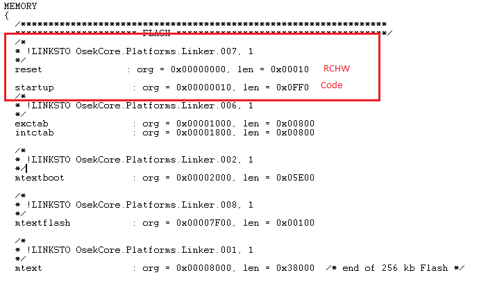

Hi Maher,
As I wrote you before, you problem was in the linker file. You should have independent section for RCHW and independent section for code behind entry point. I edited you linker and startup file and now it works correct.
I will try to explain my steps and also I am sending you edited files in the attachment.
1) I created independent sections for RCHW and code in linker file.
2) I loaded startup section to the address and correct it as VLECODE
3) I modified your startup file
4) I loaded this project to the microcontroller and now you can see that branch instructions including addresses are correct.

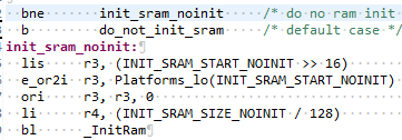

sijiahao
Hi Martin,
Sorry, I can’t give the whole source file to you..
I simplified the .s file, deleted some code, can you refer to this file?
Sijia

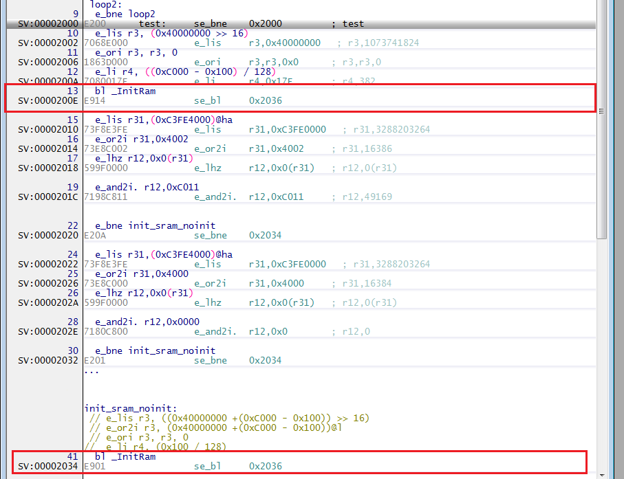

martin_kovar
Hi Sijia,
do you use BookE or VLE instruction set in your example? I see you posted here some screens with BookE instructions and you sent me file with VLE instructions.
I had took your code and placed it to default CodeWarrior 2.10 project. I tried to use the same compiler and linker setting, but I am not able to reproduce your issue. I always see se_bl instruction (see the figure below)
Are you able to create some simple project in CodeWarrior 2.10 and test, if the behavior is the same?

mahermalak
Hi Martin,
Thank you for your response.
Removing the optimization options didn't solve the problem.
I guess there is a problem with the alignment of the code, because:
  • The address 0x1E6 points to the middle of an instruction
  • here is what we have before branching to the address 0x1E6pastedImage_1.png
  • and here what we have after branching:after_branch.PNG
I attached the startup code and the elf file.
Thank you.
Maher

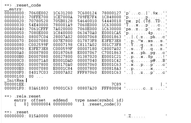

martin_kovar
Hi Maher,
thank for the file. It confirmed my suspicion about sections defined in linker file and used in startup. When I disassemble the object code you sent me, I do not see the instructions correctly. It seems you do not have .reset_code section defined as VLECODE (instructions are interpreted as data - see figure below).
Is it possible for you to send me also linker file? If not, please check the definition of the section .reset_code. It should looks like this:
If I have linker file and the startup file (I already have) I am able to create skelet project, compile it and link it and also test in the microcontroller.

martin_kovar
Hi Maher,
Please let me know if it works on your side too.
If you have any other questions, please feel free to write me back.
Martin

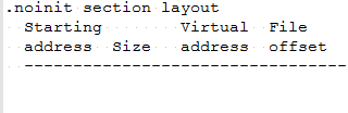

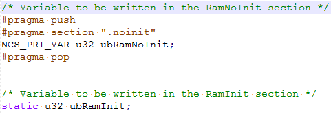

mahermalak
Hi b55689,
I have another problem that I am facing now.
I am trying to map a variable to given section that is defined in the linker file (attached before).
In my code, I have two variables, one declared normally and the second should be written in a given section (called RamNoInit, where after SW reset and during startup, the values of this section should keep their variables)
the declaration of the variables is :
The declaration of the section in the linker file :
   in Memory:
      in Sections:
In the generated Map file, we have the variable "ubRamNoInit" is not mapped in the correct section:
and the "noinit" section is empty:
Do you have an idea why i  have this problem ?
Do I declare correctly the variables ?
Do I need change something in the compilers options (attached) ?
Thank you
Maher
8,493 Views
martin_kovar
Hi Maher,
it seems that linker garbage collector optimized your code. If you want to keep the unused variables in your code, you have to place this variables to FORCEACTIVE in your linker file. Please look at the example in the attachment.
Martin
8,493 Views
mahermalak
Hi Martin,
The problem is resolved:
  • the declaration of the section ".noini" was false -> I should remove BSS
  • the declaration of the variable was false -> it should be : #pragma section sdata_type ".noinit" "noinit"
Br,
Maher
