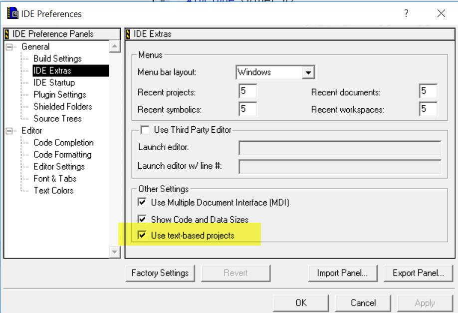

Please refer attached demo code of how to access paged RAM .
If you can't open this demo project, set your IDE as "use text based project", restart CodeWarrior.

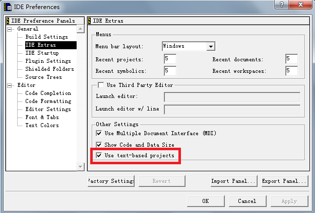

You can open CW5.1 and Edit->Preferences->IDE Extras->Click Use text-based projects like below:
And I don't use OS. The variable in paged RAM is only used in a single task(not interrupt).It is static variable, used only in one file.

yes, I figured "use text-based projects". It is the same as importing project as xml. In both cases I see rescued items and multiple include of same files.
It builds after some manipulations, but it is still not clear what should I check, which data is sometimes wrong and sometimes good, how to see it? BTW, it is not necessarily RPAGE related, it could be something else.
