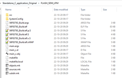

Hey,
I have a sample project for MC56F83763. Which of the compiled file I can use to flash directly to my DSC via JTAG without using bootloader?
Or do I need to create an S-Record format? If yes, then how.

You can use CW tools to download the *.elf to on-chip flash via JTAG port with the Multilink Universal FX device.
The MC56F83xxx has flashloader code in on-chip ROM, you can use blhost tools to download the *.elf.p.s to on-chip flash in bootloader mode with SCI0 port.

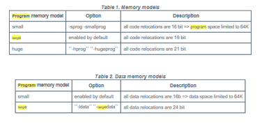

Should i use SDM or LDM as project build configuration type?
How can have my own build configuration type? For debug I need to have a configuration that sets my application to run after power on and avoid the bootloader..
What do i need to change and how do i do it? for e.g setting my my Vector Table to zero address?
@xiangjun_rong
i am porting my code from mc56f82748 to MC56F83763. i am not sure about what data model to select since it says SDM-SPM is 16 bit and limited to 64K-word of data space

There are 3 program memory models, they are small/large/super large models, corresponding to 16 bits/19bits/21bits program address.
Compiler allows the user to choose between 2 data memory models:small data mode and large data mode, corresponding 16 bits data address and 24 bits data address.
different modes corresponds different assembly instruction.

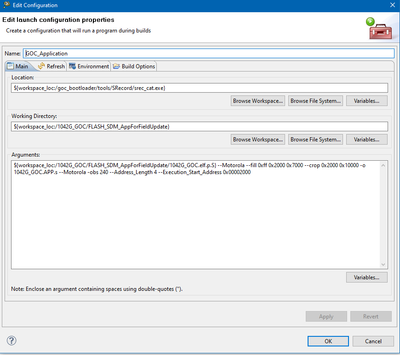

Are you sure I can use .elf file to upload using JTAG via Multilink Universal FX? Since it doesnt seem to work. Do i need to configure something else in settings?
Normally in my company, they use S-Record to flash it via JTAG? Is that better? how can i use the script to generate S file correctly? below are the settings for the old source code
fasihahmed_2-1603789657407.pngfasihahmed_2-1603789657407.pngfasihahmed_3-1603789710995.pngfasihahmed_3-1603789710995.png

Q3)Normally in my company, they use S-Record to flash it via JTAG? Is that better? how can i use the script to generate S file correctly? below are the settings for the old source code
>>>>As you have done in the screenshot, you can generate the S-Record file, you can use on-chip flashloader to download the S-record file to on-chip flash via uart0 port of MC56F83763 with blhost command.
