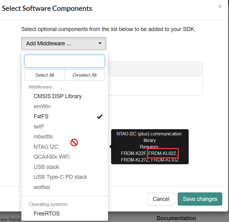

You can try using the KL02 example as a base, when you are building the SDK for the FRDM-KL03 you can see this :
 You can try to copy the folders in your project and add the different initialization, could you please check it and try this approach  and try to run the example  there in your device ?

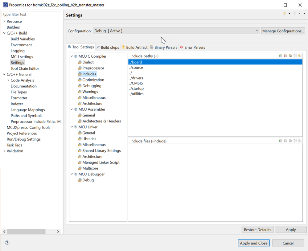

I would recommend you to use one of the I2C examples in the SDK, copy the HAL folders as well as the NTAG I2C folder and the source folder.
In this way, you already have all the project configured correctly, and you will only need to add the folders to the project path

I ended up having to change the startup files and the preprocessor steps. It is working now thanks.
