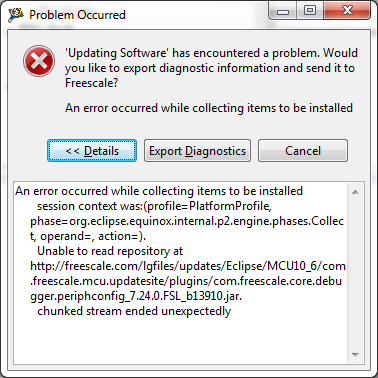

CW 10.6 adviced me to make an update.
See the picture below:
If no picture exist anymore, here is the text
An error occurred while collecting items to be installed
session context was:(profile=PlatformProfile, phase=org.eclipse.equinox.internal.p2.engine.phases.Collect, operand=, action=).
Unable to read repository at http://freescale.com/lgfiles/updates/Eclipse/MCU10_6/com.freescale.mcu.updatesite/plugins/com.freesc....
chunked stream ended unexpectedly

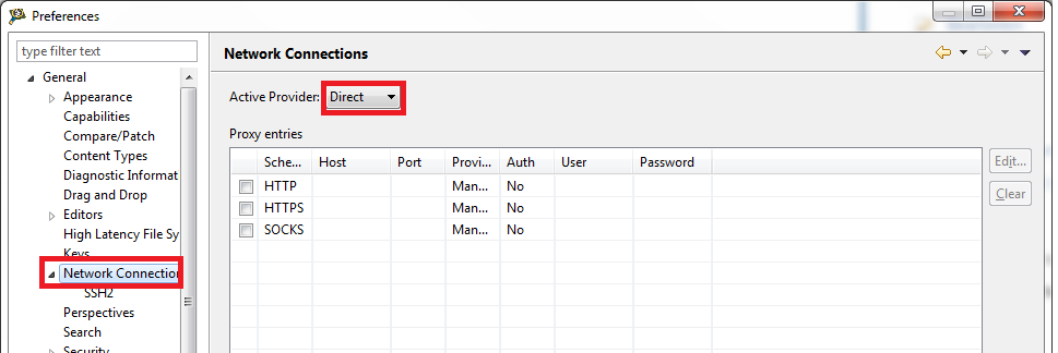

found the Error.
Our firewall stop the transmission.
Could be solved by making changes here:
\Window\Preferences\...
