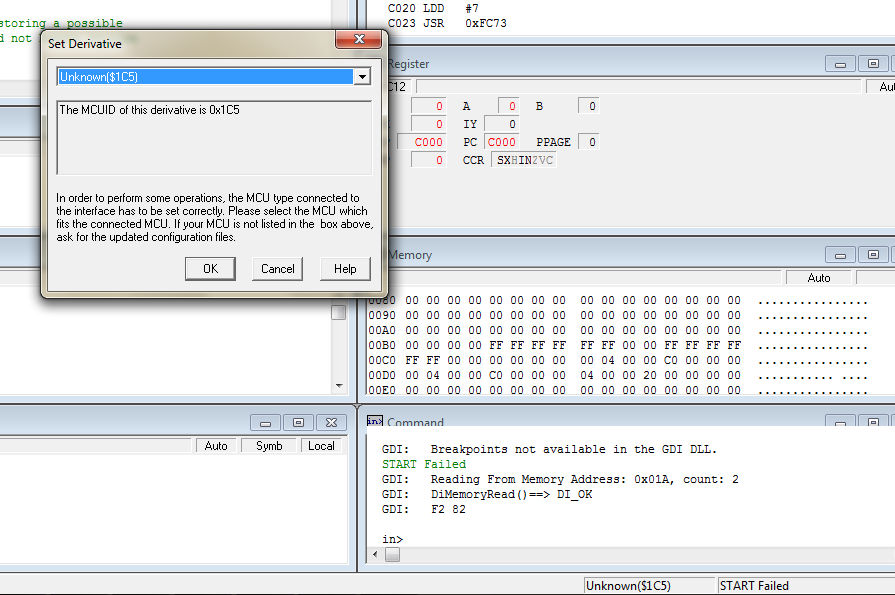

mithunbharadwaj
Please provide the updated Configuration file for selecting MC9S12G48 MCU.
Also Break points are not available for debugging.
1,587 Views
ZhangJennie
Hi Mithun,
to work with 9s12g48, please install:
1. CW5.1:
http://www.freescale.com/webapp/sps/site/prod_summary.jsp?code=CW-HCS12X
2. patches:
(1) CW12 v5.1 Compiler Update
(2) CodeWarrior for HCS12(X) v5.1 G64 Service Pack
from:
Updates for CodeWarrior for HCS12 v5.1
it should work.
this answer is for you. if it helps, please click on "correct answer" button. thanks!
ZhangJun
