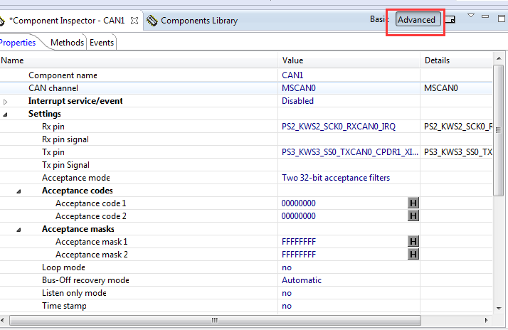

Hello Mahendra,
- Yes,  in the chip of MC9S12ZVC128MKH,  the pins CANH and CANL signal are not available,
we can see it from the Reference Manual, you also show it on the former information :
- About the Processor Expert configuration , please select the "Advanced", then you can see the more conifguration
selection :
Hope it helps
Alice

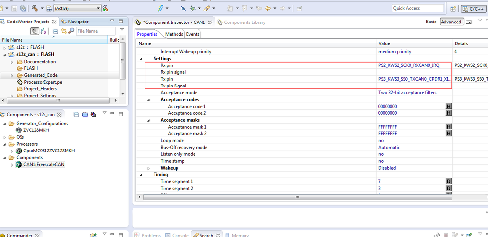

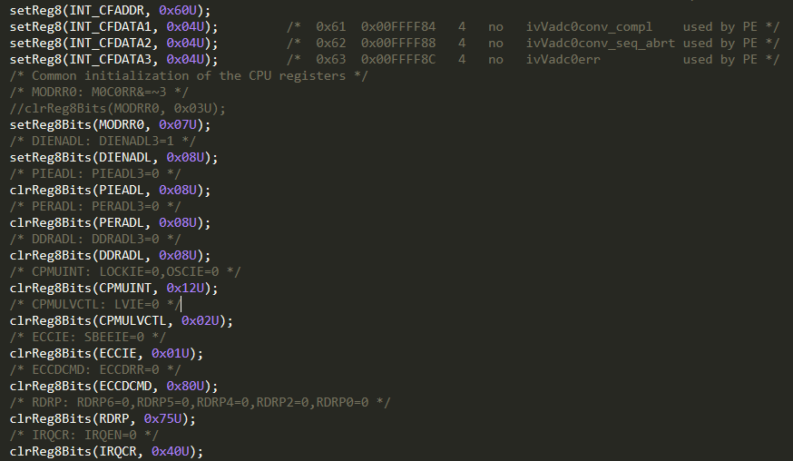

Hi Alice,
We need the CAN messages to show up on pins 29 and 31. They seem to show up just fine on PS2 (pin 36). I think the problem lies in routing the CAN messages to the required pin. From what we understand the register responsible for routing the CAN lines is MODRR0 which we tried setting to values from 0x00 to 0x07 with no success. Below are the registers values we are setting -
We have also tried toggling the Split enable on and off but it doesn't seem to have any effect.
Can you think of any registers that we need to set or any flags that we are required to enable to route the CAN lines to PIN 29 and 31? Once again deeply appreciate  your help regarding this matter.

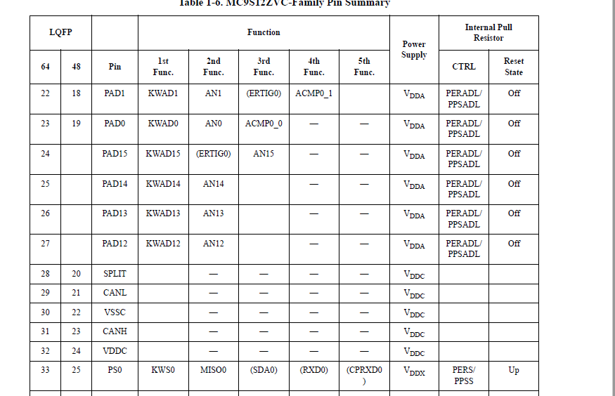

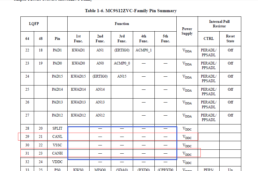

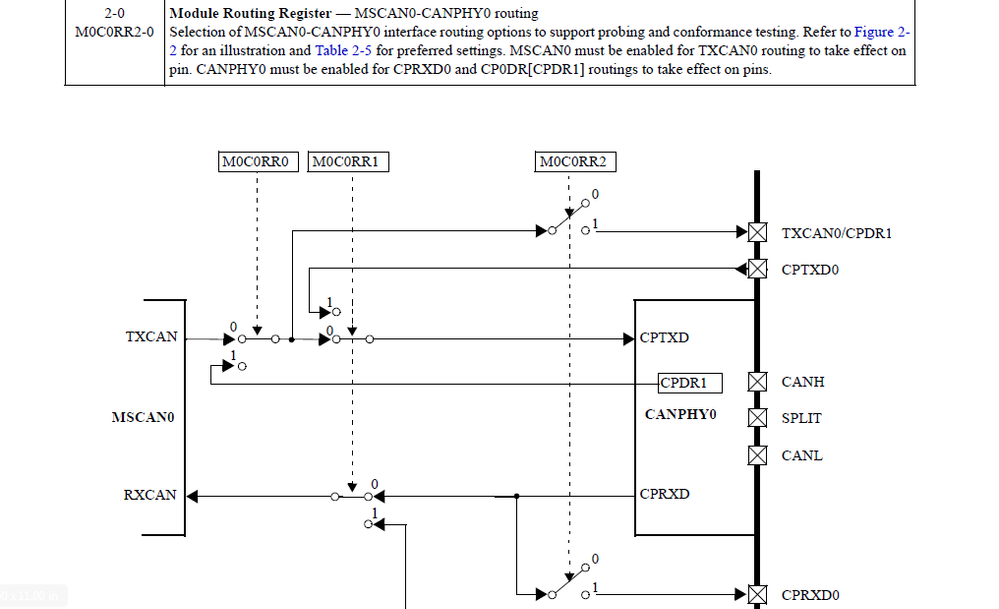

Here's the specific problem.
So the CAN has been exposed to 3 different cpu pins PS0-PS1, PS2-PS3 and then there is CANH and CANL(pin 29 and 31). We can't seem to get it to work with CANH and CANL. It works on the other ones. In the initial part of the documentation there are dashes meaning 1st, 2nd, 3rd, 4th functions dont exist. We have had very little luck modifying MODRR0 to route it to these pins. It does not want to route MSCAN to CANPHY. So the question is has been removed and only 2 sets of CAN exists PS0-1 and PS2-3. I have attached the section with the dashes. We can't make heads or tails of it. CANH_PHY.png If you could confirm these CAN lines have not been discontinued can u please show us the exact way to configure it.
Thank you.

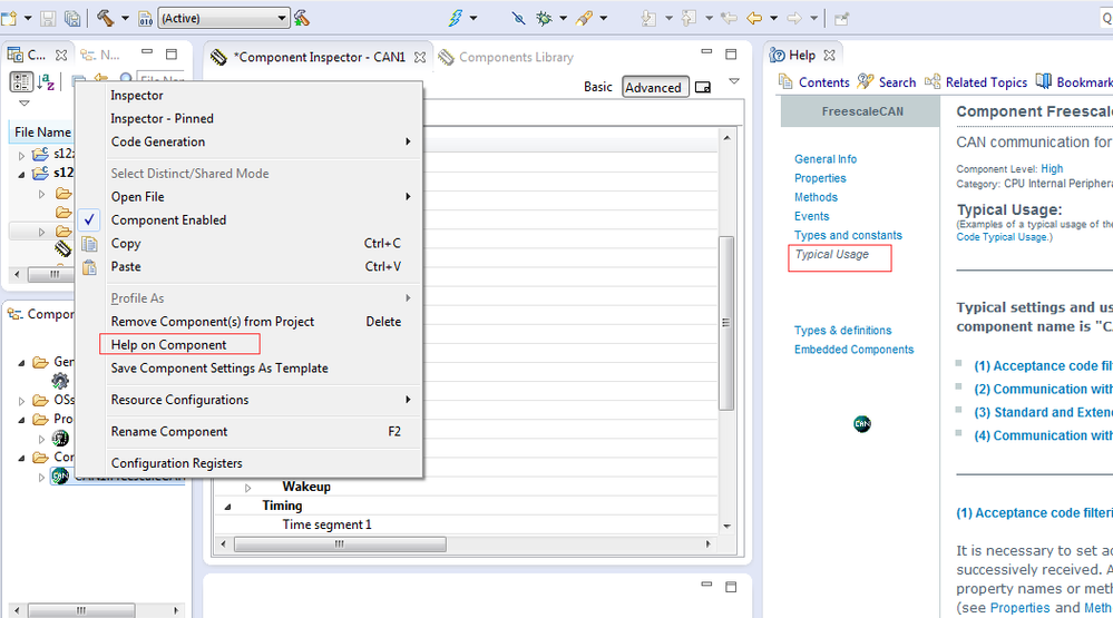

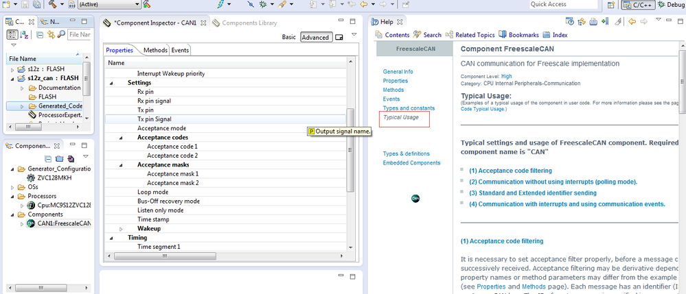

Hello Mahendra,
- About the CAN module routing , please refer to Reference Manual :
- I see you use the Processor Expert,  after you add the component of CAN, you can configure the pin on
the component directly :
And there is demo code , you can also refer to : Right click the CAN component , then select "Help on component " ,
Then select "Typical Usage" :
- If these all can not help you , could you please tell me which pin do you want to be used as CAN pin , and
does your question is you do not know how to configure ?
Hope it helps !
Alice
