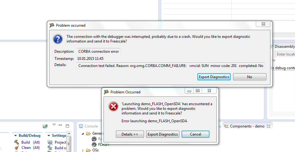

hi,
I'm trying to debug with cw10.5 the frdm-K20D50M, but i have errors. When debug, this message error apear: "Unable to find the CodeWarrior Debugger Engine executable."
In the "freescale/ MCU/bin" folder, the DE.exe doesn't appear, and this is weird, if someone can help me...

Hi Carles,
I think your firewall/virus might have removed the DE.exe and moved it into a quarantaine folder. Can you check this?
Probably because the DE.exe wanted to establish a network connection with the debug probe.

carlesricart
Hi Erich,
I desconected the firewall and antivirus and the problem persist.
At first moment, the DE.exe exsist, then when try to debug appears the next error, and then DE.exe disappear.corba error.PNG

Erich,
You are correct. The antivirus stopped DE.exe and I didn't see.
Now works. Thank you for all.
