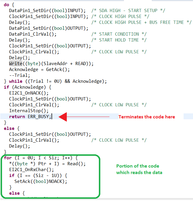

I have a question regarding the external I2C block in Processor expert. I am using CodeWarrior version 10.6.4 and the micro controller is part of the MC9S12ZVC family and I am using a USB multilink universal debugger to communicate. I am trying to receive messages from my processor to a tilt sensor (MMA8653FCR1). When I step into the code of the receive block (EI2C1_RecvBlock) it looks like the data is never received.

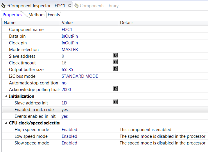

As per the code above, the value of acknowledge is always set to '1' which I assume means that the tilt sensor has received the data request. Below is a screenshot of the configuration -
Is there some sort of basic mistake that I am committing ? Also am I supposed to see pulses in the IICSCL or IICSDA lines when I transmit data (using EI2C1_SendBlock) ?

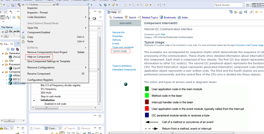

If the signal is right , then you can   refer to the Typical usage : right click
the component , then select "help on component" :
Hope it helps

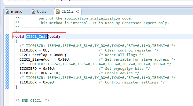

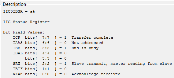

I assigned the register IIC0IBCR register to 0xB0 which enables IIC bus module, sets Master mode and sets the transmit bit. Although when I do this the register IIC0IBSR gets set to 0xA4.
Do you think this could be one of the problems ?

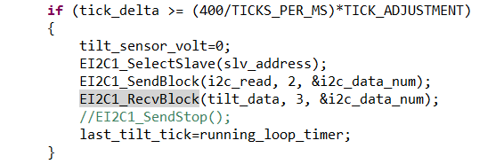

Below is a snippet of the part of the code which transmits and receives data -
It looks like the main problem is the lack of clock pulses on the IIC0SCL line. Do let me know your thoughts.

Hello Mahendra,
- Please pay attention that , if you use the processor expert , you needn't configure
the registers for initialize I2C . After configure the I2C component , then the initialize
code can generate :
-From your detail of the IICSDA and IICSCL signal, i think the I2C have not been start ..
So recommend you first refer the demo i mentioned last time to test .
