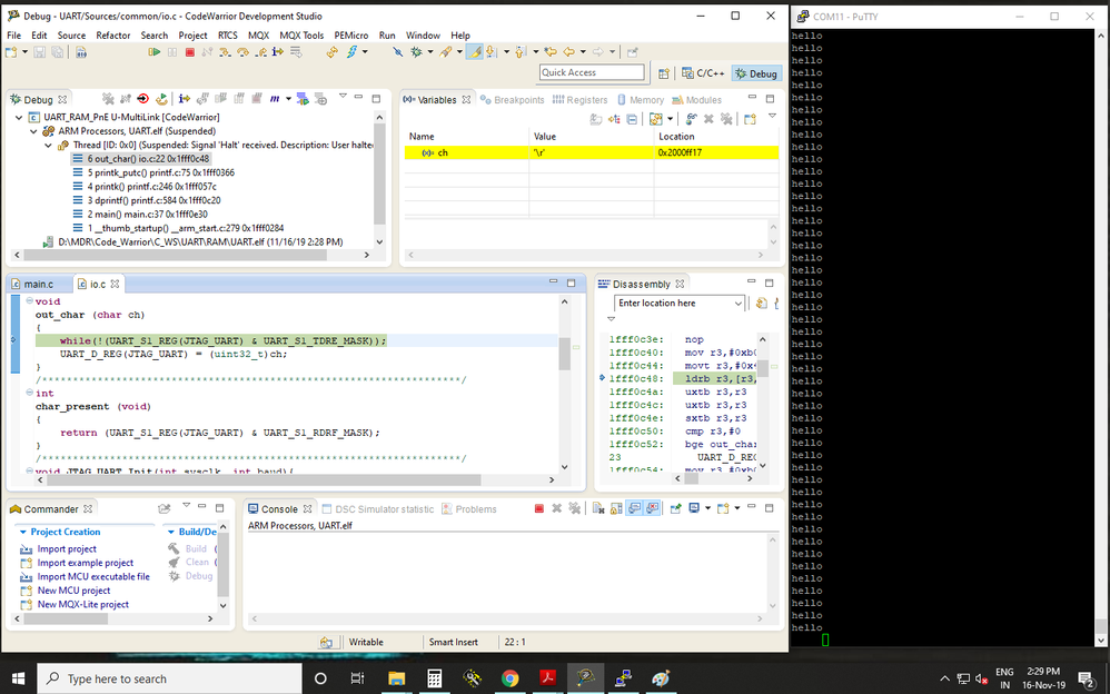

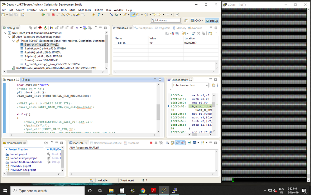

   I am using k60 microcontroller for my project. I am facing problems in printing the data at higher baud rates using UART.
   I am using 50Mhz clock with PEE mode.
   I have uplaoded the photos please check it and help me out in this please .when we use 115200.pngwhen we use 256000.png

Hi Mohammedrasool,
 I also see this problem on my board. I think this maybe the on board OSBDM bridge problem. It can't support such a high speed. I observe the UART waveform on oscilloscope, the baudrate of TX signal from K60 is fine. If high speed is must, you have to change to other route.

K60 has 5 uart. You can use other uart port and use a usb-uart converter to connect computer.

   In K60 Uart 5 is directly connected to usb in which i am having trouble may be the usb cannot handle that much high speed.

Yes, I think so. MC9S08 is a 8bit 51 core MCU. It is not as powerful as openSDA K20 mcu. That is a M4 core MCU.

Thank You Jing Pan, now i got the answer we have see for other option to transfer at such a high speed like ethernet.
