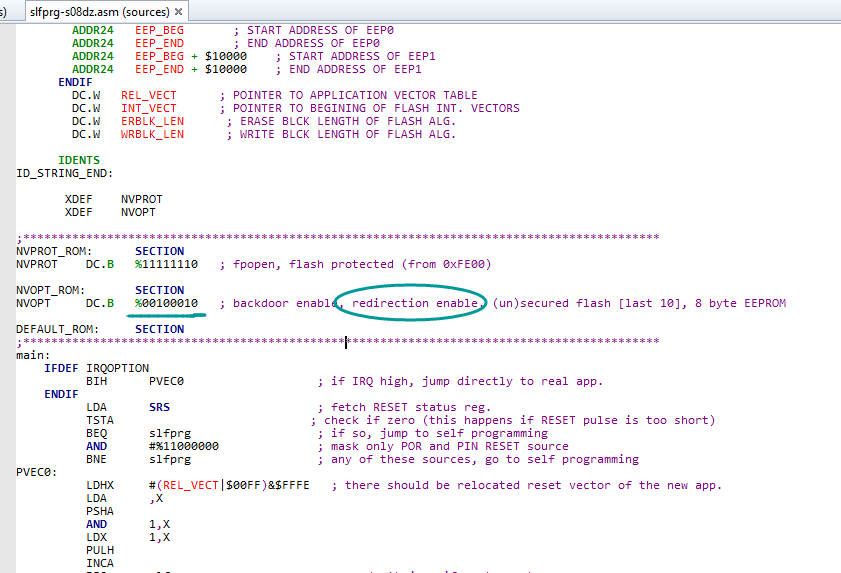

Hi Alice. I appreciate your help. I tried what you suggested however I am unable to do step 3 ii enable vector redirection. Maybe I am doing it wrong. According to the datasheet  for this MCU, "Vector redirection is enabled by programming the FNORED bit in the NVOPT register located at address 0xFFBF to 0." However, that is a program once register and will not allow me to change it. So how can I enable the vector redirection?

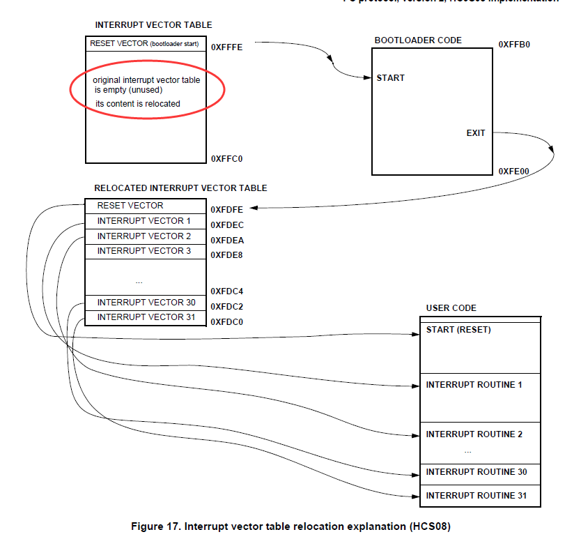

Hello Mike,
I asked some other colleague and check bootloader information about 8 bit MCU.
It seems the boolotader  usually do not use interrtup.
I refer to the AN2295 ,  the original interrup vector table is empty:
Also there is a part about interrupt relocation:
4.4 Interrupt vector table relocation.
Then I checked the source code , it is enable vector redirecton in bootloader code:
