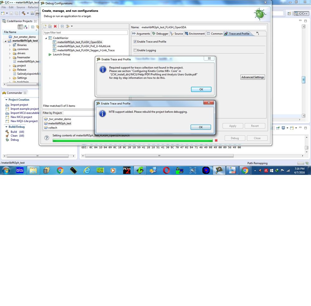

        I am new to codewarrior 10.6 and trying the demo code "emeter demo".
1) i want to know the time to execute a loop.I tried as per the "profile and trace guide.pdf".But it is reporting error.
    please help to solve this.How to include sa_mtb.c in an existing project.

       Thank you for your reply.I tried it.But still the error comes.I attached the screen shot.trace_eror.jpg

Hello Venkat,
So have you rebuild your project ?
And also  i recommend you one DOC about the usage of Trace on CW :
https://mcuoneclipse.com/2013/01/13/debugging-arm-cortex-m0-hard-fault-with-mtb-trace/

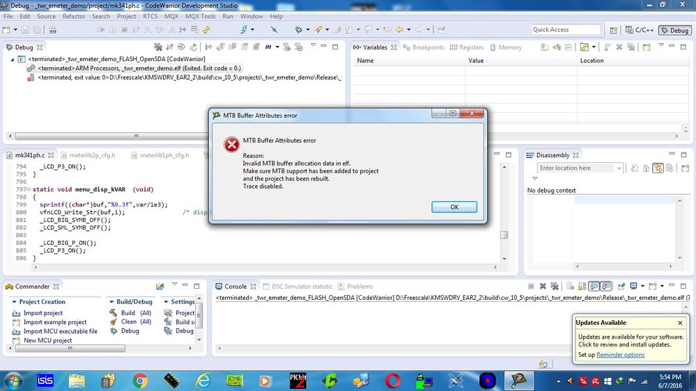

venkatkrishna
Hello Alice,
                 Thanks for your support.
I rebuild the project and click the "debug" command.It show the report as below.Pls Help me to solve this.MTB_err1.jpg

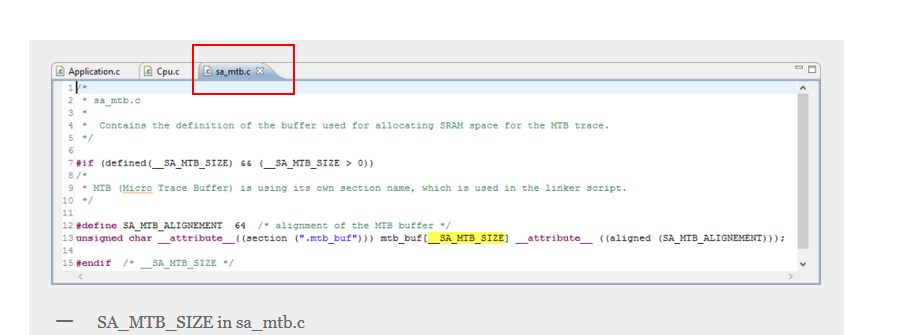

Hello Venkat ,
Please check the .ld file whether mtb_buf is added to the m_data section.
Also check whether the project includes the file of "sa_mtb.c"
You can also create one simple project , then test this function ,
if it still have error , you can send the project to me .
