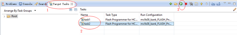

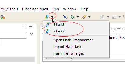

Hello Brandon Doucette,
You can choose Tasks on "Target Tasks" view :
You can also choose on below:
Hope it helps
