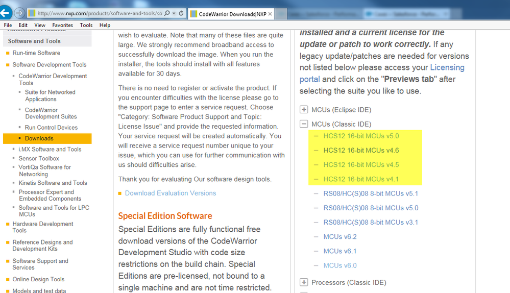

ZhangJennie
you can refer this article to download update
How to download a Service Pack / Patch / Update?
there are also some updates listed here
CodeWarrior Downloads|NXP
but i just have a quick check, seems there is no 9S12A derivative service pack
thanks for your point, I add this part to my article.
Jennie Zhang
