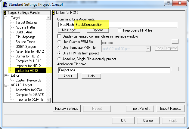

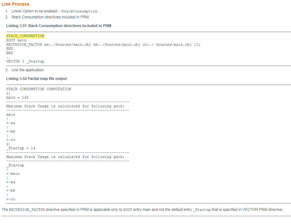

ZhangJennie
You can use stack consumption feature to check maximal stack usage.
There are two steps to do it:
    1. Linker Option to be enabled: -StackConsumption
    2. Stack Consumption directives included in PRM.
I captured the related from help manual:
You can also find more information in help manual, search the doc with key word “STACK_CONSUMPTION”
Can this help you?
