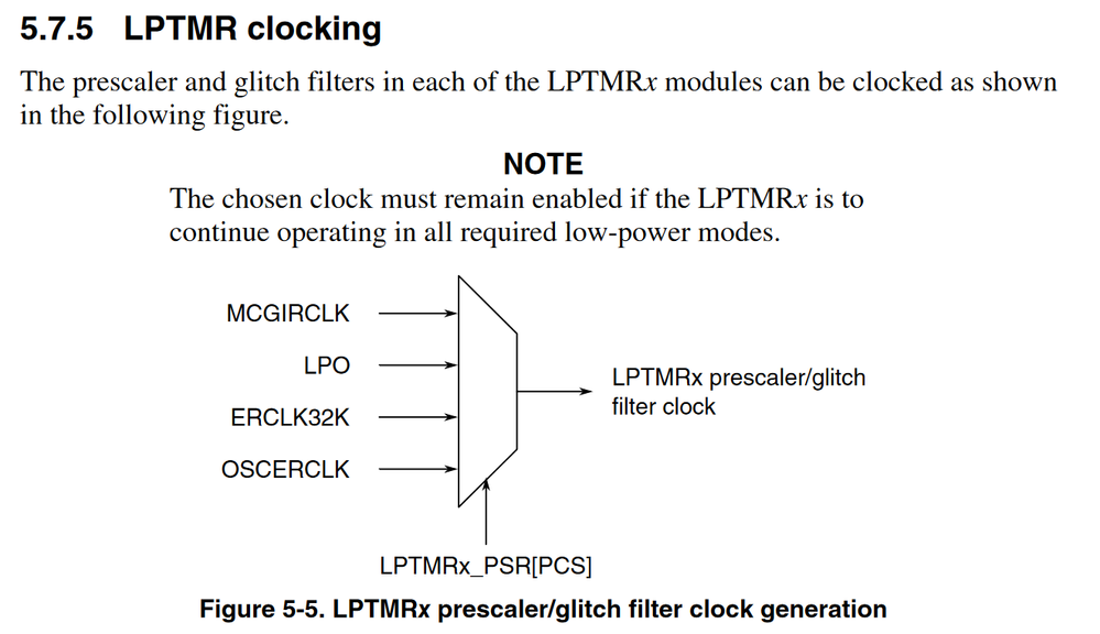

I have question on the K60 micro sleep!
We are running our K60 micro MK60DN512VLQ10 from a system oscillator 16MHz clock (Core clock is 96MHz) and we also have the external RTC oscillator 32.768kHz.
We have a low power requirement when battery powered.
In this low power mode, we sleep for 250mS and wake up and check for reason to wake and sleep again.
During this 250mS sleep the only thing needed to work is wake up from pin change/pin interrupt.
Requirements:
So looking at the power mode options, VLPS is the most appropriate mode although we are happy to consider other power modes.
I am also thinking we could use the 1kH LPO for the sleep clock but not sure it can do 250mS. This can be utilised with the internal wdog?
We don’t need super accuracy but the 1kHz clock has +/-10% accuracy and it is pretty bad. So I am wondering whether we could calibrate the 1kHz. May be another way?
Any sample code/app note for this?

According to your requirements, the VLPS is a good choice since the wake up from pin interrupt is available.
Just to clarify, what do you mean for "The LPO can do 250ms"? It's important to consider the transition time between the power modes, for the case of VLPS to Run the time is 2-4us + 12 clock cycles.
The LPO can be used with the watchdog and its available in VLPS.
Unfortunately, the LPO can't be calibrated, I apologize for the inconvenience this may cause you.

I've been doing some configuration with PE to enable the VLPS  but unfortunately, this option is not available in CodeWarrior. This need to be written, I suggest you take as reference the SDK power management examples.
If you want to use the external 32KHz clock, you may want to use the LPTMR clock and attach the external 32Khz clock as source. The LPTMR can set an interrupt in order to wake the device.
