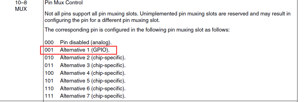

Hello SCOTT,
Have you configure the pin PTA4 to GPIO function on the register of
PORTA_PCR4-> MUX
About the k22 , i only have FRDM-K22, while the CW doesn't support it , so i test on FRDM-K64 board,
while it is the same .
I set the PTE26 to low , i write the below codes in the file of init_kinetis.tcl:
reg SIM_SCGC5 = 0X2000
reg GPIOE_PDDR = 0X04000000
reg GPIOE_PDOR = 0x00000000
reg PORTE_PCR26 = 0X0100
Please refer to this configure your pin.
Hope it helps
Alice Yang
