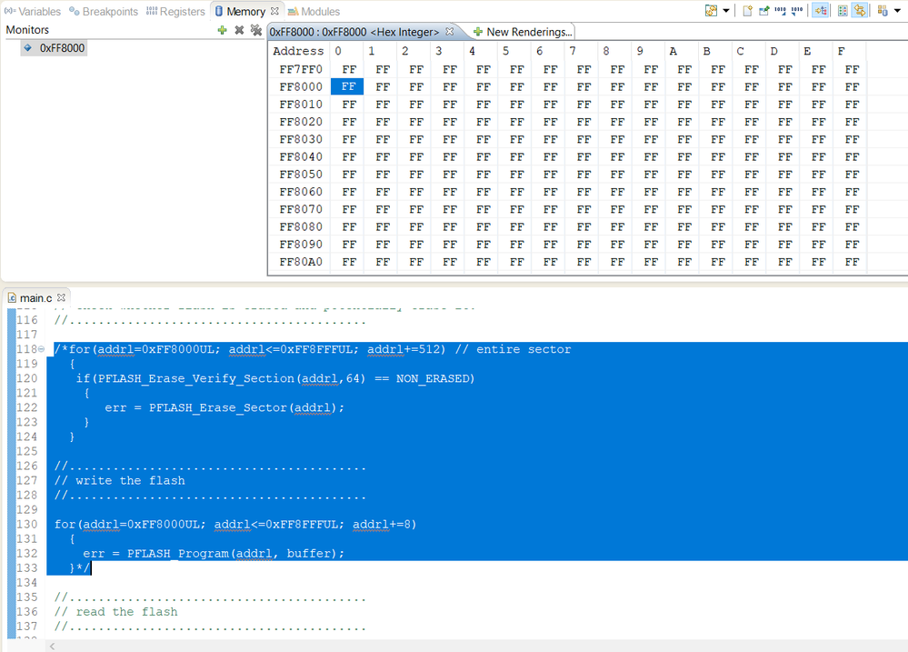

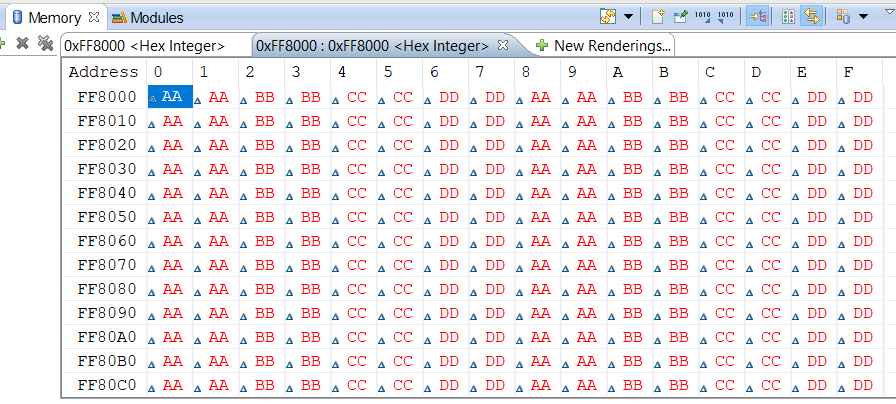

I'm programming NXP (Devkit S12ZVC) for the first time and i have eeprom and flash problem. I could write any data to EEPROM or FLASH (I checked on CW memory monitoring) and i could also read. But the data disappears every time (all eeprom bytes are 0xFF) when i reset the MCU or i power off and power on again. So i tried to write to FLASH, but I had the same problem with FLASH too. I used Processor Expert and another library too, but the problem still continues. I think i have a simple problem but i dont know that what i dont do or do wrong. I'm waiting for your helps.

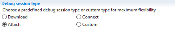

If you want to check/ debug the data in flash memory after reset you can use the Attach option in Debug session type in debug configuration.
Attach option assumes that code is already running on the board and therefore does not run a target initialization file.
Every time you run/debug with Download session type the new code is downloaded into MCU, so, the flash is erased and a new project is loaded into MCU. So, you lost the stored data by the previous project.

Thank you Ms Diana, "Attach" mode solved my problem when I am working with debugging. But I always have to download the codes, so I tried the "Custom" mode and unchecked the "execute reset sequence" and "execute startup scripts" options. And it fixed :smileyhappy: Thanks again.

Firstly thanks your answer. I tried simple eeprom and flash projects (ZVL32-Eeprom-CW106 and ZVL32-Flash-CW106) that you suggest but the result has not changed. The data disappears again. By the way I tried the projects with 2 different S12ZVC Devkit  however I had the same problem. I am reading 0xFF when I ignore codes of erasing and writing.

Which flash address do you use?
Could you try a simple flash example without PE to verify that the issue is not in SW? see attachment

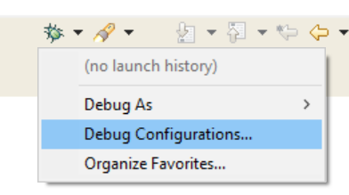

Also, can you share the screen from the debug configuration?
