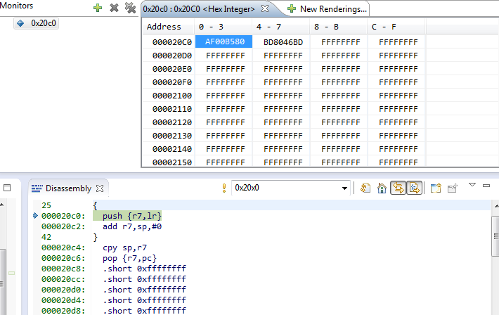

When i run hw_InitLL(); in program code, then it executes fine as expected. U can see assembly and memory content in this prtscr

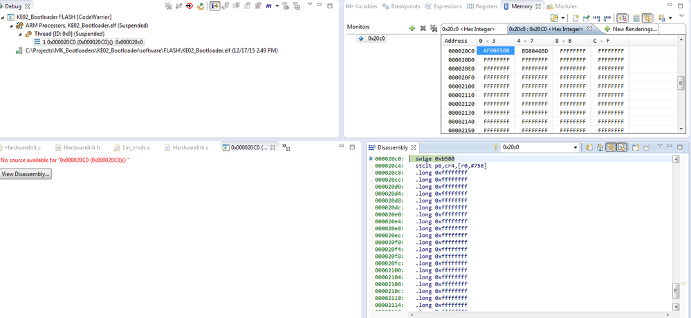

in BL code :
When i run ((void (*) (void)) 0x000020C0) (); , then it jumps to addess 0x20C0 as expected. i can see the memory content is the same, but there are other assembly instructions in disassembly window (see prtscr). When i step further i run into a hardware fault
I did use a HardwareFault component in processor expert. This gives me stacked_lr : 5159 -> "Unable to retrieve disassembly data from backend".
My Question
Why do i see the same memory content but is codewarrior not able to show these as assembly instructions?
Why do i run into a hardwarefault?

Are sure you have flash the function correctly -> both programs are flashed in different FLASH area's , when i debug bootloader code i make sure i don't wipe  Program code. i'm sure the hw_InitLL() instructions are still in flash when i call them. Thats what u see in the examples at address 0x20C0.
I also tried to run the code without debugger as this is maybe just a debugger issue, but then it also dont work .
U are right that the debugger says No source available, thats what i try to figure out why this is. I just want to execute "RAW "assembly instructions from flash address 0x020C0 and jump back in bootloader code . But the moment i the code at 0x20C0 starts to execute, it seems to generate an exception error.
hw_InitLL() resides only in Program Code. I compile BL code and Program code separate.
And what's different between the two test above you said. -> one test is in Program Code that shows the moment i jump into hw_InitLL() , the other test is in BL code where i jump to the address where hw_InitLL() code is located .
