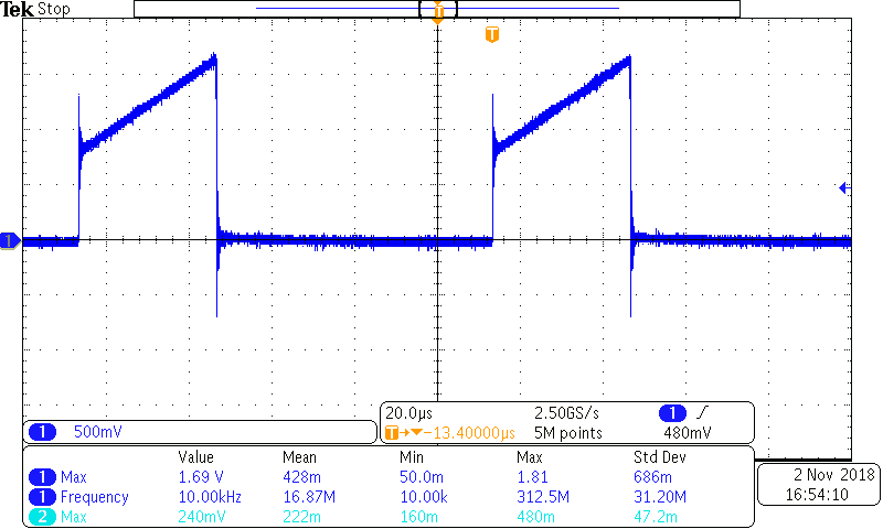

In another ISR , ADC High Limit Interrupt, I am trying to read the ADC value at a specific point (please see the attached figure- I am trying to read the minimum value). I am using the following simple code to read the ADC result when the interrupt happens (Sample 0 > 0.85 V). However, I am reading multiple values (gradually increasing) instead of just one when the interrupt happens. Also the values are changing all the time. I am using a structure named adc0_array to save 100 values. Will you please let me know where is the problem?

Regarding the reducing the interrupt latency, you can use fast interrupt. Pls refer to the section:
12.3.3 Fast Interrupt Handling in RM of MC56F827xx.
You can use the signal in crossbar switch module to trigger ADC. pls refer to section 3.3.3 Inter-Peripheral Crossbar Switch (XBAR) and AND/OR/INVERT (AOI) Configuration

Thanks for your recommendation. Polling seems to give me slightly better results. However, I am still getting different values for different cycles. My first question, what can do to get consistent ADC values for different cycles of the feedback signal? The second question is, how can I make sure HILIM ISR executes only once a cycle to get the minimum value from the feedback signal (ref to the previous figure)?
