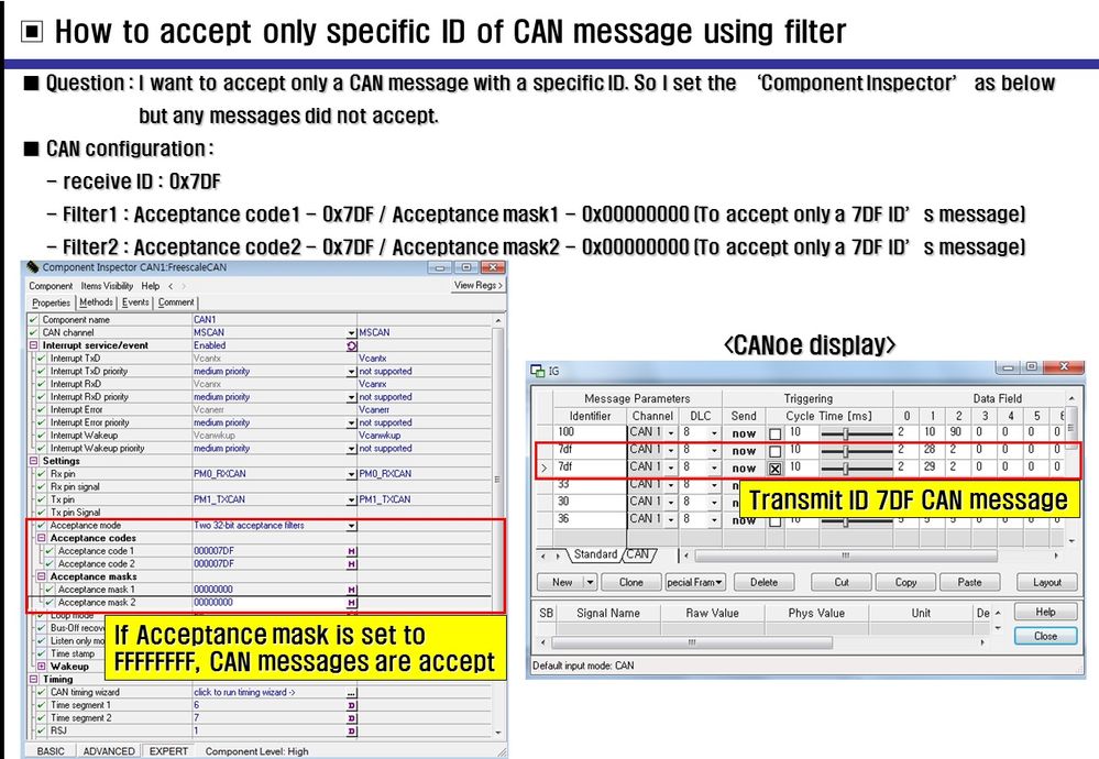

trytohelp
Hi Kim,
Early this year I've contacted the Processor Expert team for similar issue.
I've received feedback.
See below:
We have received the following feedback from the development team than analysed the issue:
- per manual recommandation (see footnote in chapter 8.4.3 Identifier Acceptance Filter), option "Four 16-bit acceptance filters" should be used for "Acceptance mode" property for standard identifiers.
- according to chapter 8.3.2.18 MSCAN Identifier Mask Registers (CANIDMR0-CANIDMR7), in order to receive standard identifiers in 16 bit filter mode, it is required to program the last three bits (AM[2:0]) in the mask registers CANIDMR1, CANIDMR3, CANIDMR5, and CANIDMR7 to "don't care". This accounts for the last 3 bits of the ID registers, which are unused. So, the two acceptance masks should be 0x00070007 (two filters per mask).
- the ID value must be in the most significant 11 bits of the CANIDARx registers, in order to compare them with the ID registers, who format is described in chapter 8.3.3.1.2 IDR0-IDR3 for Standard Identifier Mapping. 0x7DF << 5 = 0xFBE0. So the two acceptance codes should be 0xFBE0FBE0 (two filters per code).
You can download the reference manual on the web using the link:
       http://cache.freescale.com/files/microcontrollers/doc/ref_manual/MC9S12P128RMV1.pdf
Hope this will help you.
Pascal Irrle

kimjunghyun
Hi. Pascal.
I could not understand how to apply datasheet’s explanation to the Processor Expert(don’t care processing) but I could understand it through your answer.
Actually I have to use extended ID. So I set as below but CAN data was not received. I need your help.
ID that I have to receive : 0x18ff56e7, 0x18f00503
Setting for Processor Expert
- Acceptance mode : Two 32-bit acceptance filters
- Acceptance code1 : 18ff56e7
- Acceptance code2 : 18f00503
- Acceptance mask1 : 00180000
Thank you.

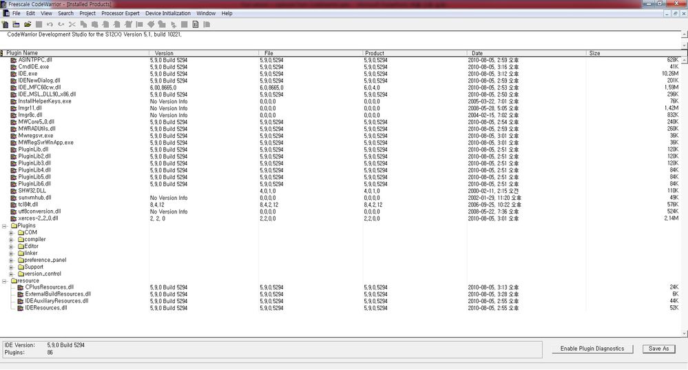

kimjunghyun
Hi. Pascal.
Please refer as below picture.(Tool version)
But I could not find any icon to attach the txt file so I copied and pasted it here
Thank you.
Kim.
