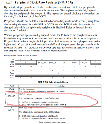

As you know that the SCI0 driving clock can be BUS_CLK or 2xBUS_CLK.
Pls check if you use BUS_CLK or 2xBUS_CLK by checking the SIM_PCR register.
This is from the RM of MC56F827xx.
Hope it can help you

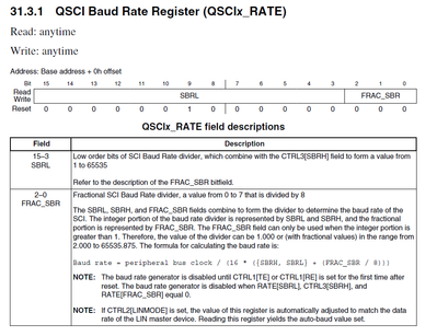

If the BUS_CLK clock frequency is 30MHz, the baud rate will be:
case1:
using BUS_CLk - 0104(RATE),  baud rate=BUS_CLK/(16 *SBR)=30MHz(16*32.5)=57.7KHz instead of 115.2KHz
using 2XBUS_Clk - 0209(RATE),baud rate=2XBUS_CLK/(16 *SBR)=60MHz(16*65)=57.7KHz instead of 115.2KHz
Obviously, the code generated by PE has issue. Now and in the coming days, only SDK will be supported.

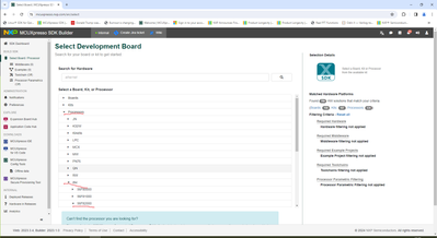

can i get SDK for my controller (MC56F82746)?
5,980 Views
xiangjun_rong
As you know that MC56F82746 does not have tower board, so you have to select Processor as the following fig:
XiangJun Rong
5,977 Views
Ujwala_kontham
even after downloadind SDK of 2746 getting the project of 2748
