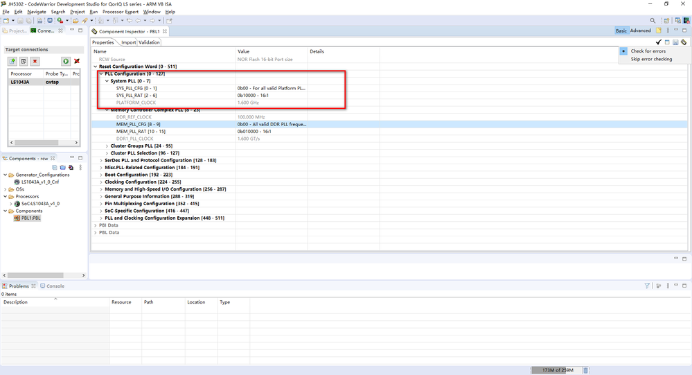

QCVS can not check error
1,804 Views
arm_linux

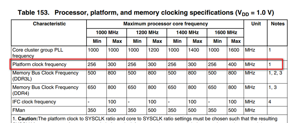

I am use QCVS(CodeWarrior for ARMv8 v2020.06) to config rcw,I entered a value that is not supported in the manual, but no error
1,771 Views
yipingwang
Please download armv8 11.5.5 pack form the
following link and open CodeWarrior IDE to install it from Help->Install New
Software->Add->Archive.
https://drive.google.com/file/d/1ZHiYWDOhb27o0oD5Brqjn4_vJzRUCKoY/view?usp=sharing
