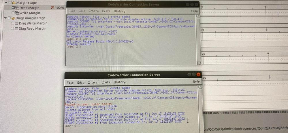

OneNote
Thanks.
Now it's back to 4.22.
There is a new issue happen when run the margin test.
Log attached.
12,912 Views
yipingwang
Please open CCS console on the right bottom of your task bar, type "log v", then connect to the target board again, the low level CCS log will be printed out.
Please send the CCS console log to me to do more investigation.
12,907 Views

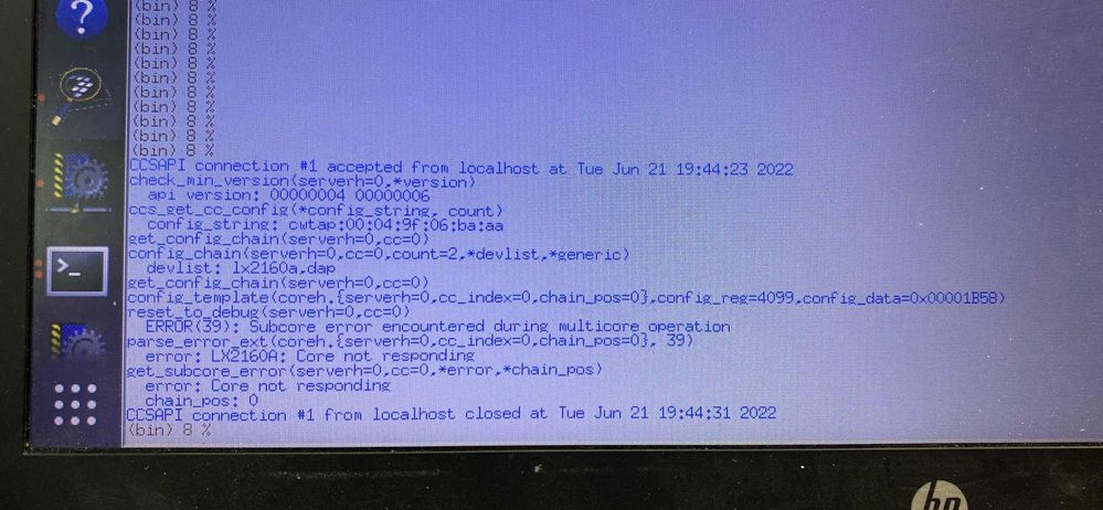

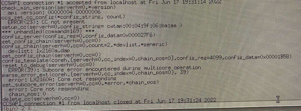

OneNote
Is this what you want? Thanks.
12,905 Views
OneNote
12,881 Views
yipingwang
It failed at "reset_to_debug". If the RCW is valid, probably there is hardware design problem of the JTAG interface on your custom board.

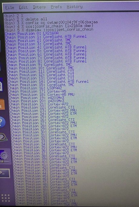

yipingwang
Please also try the following commands in CCS console.
delete all
config cc cwtap:<ip>
ccs::config_chain {lx2160a dap}
display ::ccs::get_config_chain
::ccs::stop_multi_core {21}
::ccs::reset_to_debug
12,853 Views
OneNote
12,851 Views
yipingwang
