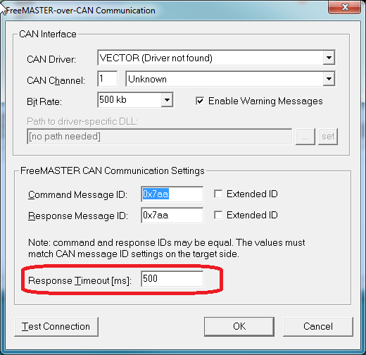

hello:
       i intergrated the freemaster codes into my application code,and download the S19 file into the evaluation bord.
       the communication configuration is :
      (1)short-inter mode;
      (2) the FMSTR_Poll() is in for(;;),FMSTR_Isr() is in can receive interrupt function; FMSTR_Init();
      (3)FlexCAN,  SPC56**
Then, the result of “Test Connection”:
                  " target is alive (responded to ping)"
           the standard frame 0x7aa send and the response is received,but in the next step i click the button " STOP " to start communication,the results is below:
           " Can not detec the board information! the  communication  will paused. Error code: 0x858e0003
I have several questions:
(1) Freemater through CAN, the protocol of communication is XCP/CCP? because i do not find the protocol in the specification,please confirm the information。
(2) without can protocol,how can i fix the problem?
                   looking forward to your  response,My E@mal is" [email protected] ", thank you.

To make the debugging of this issue a bit simpler I'd recommend you to start with polling mode first since the complexity of the interrupts is not involved.
#define FMSTR_POLL_DRIVEN 1
Please make sure CAN ID on the target matches with embedded side (FMSTR_CAN_CMDID, FMSTR_CAN_RESPID - freemaster_defcfg.h). Default value is 0x7aa.
Also you can try to increase the response timeout:
FreeMASTER does not use XCP/CPP protocol but its own protocol (see fremaster_protocol.c/freemaster_protocol.h)
Hope it helps.
