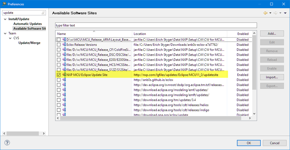

It seems to me that you try to update from a local JAR file.
Go to the setting (Window > Preferences) and only have existing files/sites checked, for example only the NXP MCU update site:

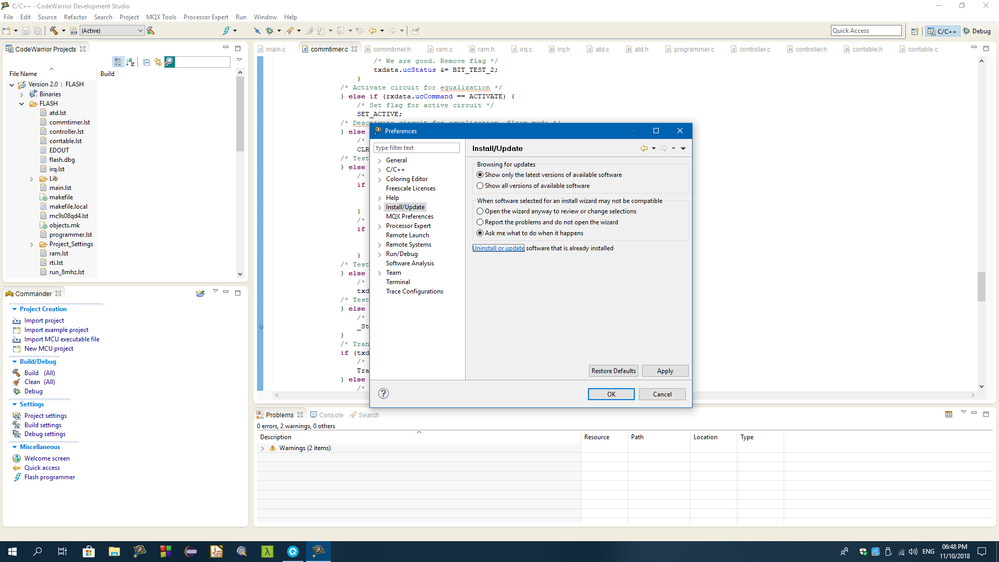

perhojfeldt
Hi Erich
Thanks for your help but when I do (Window > Preferences) this is the picture I get.
Per

BlackNight
You have to check the available update sites as shown in my screenshot.
