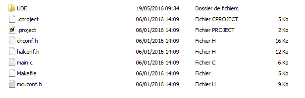

I found a demo for my PowerPC using a RTOS. It uses Eclipse. Below, you can see the project.
But I have to use Codewarrior.
And I don't know how to port a project from Eclipse to CodeWarrior...
Thank you for your help.
Best regards.
Louis

I mean the compiler used in the project is not the one used by CodeWarrior. Is it a problem?

Please refer to this link:
https://mcuoneclipse.com/2012/05/07/exporting-and-importing-projects-in-eclipse/
If your project does not use CodeWarrior compiler and linker, I would recommend creating a new bareboard project in CW10.6.4, and then add/copy all your source files to the new project. This is the cleanest way to import a project. Below is an application note for how to do this:
http://cache.freescale.com/files/soft_dev_tools/doc/app_note/AN4727.pdf
