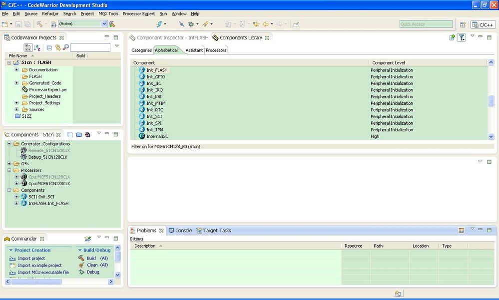

I have a project that was created in 10.4, on a 51CN128, and uses Init_SCI and Init_Flash. Both work and compile in 10.4, but when I try and load the project in 10.5, PE tells me that the component is not supported by the target processor.
Any ideas?

I create a new 51cn  project i can see Init_SCI and Init_Flash available. see below:
