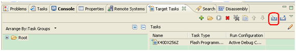

One solution in CW 10.1 would be to use Target Tasks to download the application.
To do that, from Target Tasks view, you need to:
  1. Import () Flash_Programmer/ARM/K40DX256Z.xml.

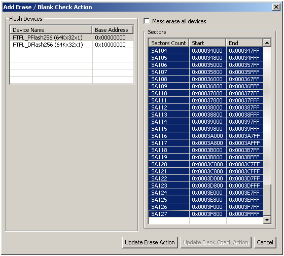

2 . Double click on the “Erase” action to edit it
3. Uncheck “Mass erase all devices”
4. Select only FTFL_PFlash256 from the left hand grid box and select the sectors you need to erase
5.      Click “Update Erase Action”

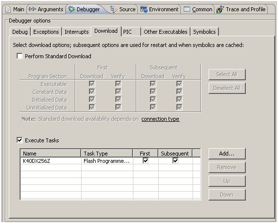

8.     Open Debug Configurations/<Your Download configuration>, Click on Debugger tab, then on Download Tab
9.     Uncheck “Perform Standard Download”, and check “Execute Tasks”
10.      Add... the previously edited target task “K40DX256Z”
11. Click Apply
