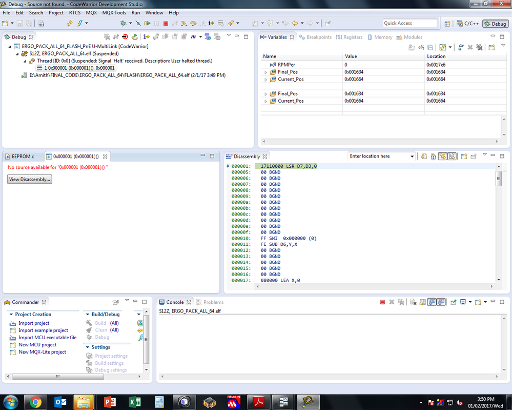

I am trying to debug my code in codewarrior it is showing following error.
It is showing following error :: No source available for "xx".
I attached screen shot of that error. During build, there is no error.
But while debugging after sometimes it is giving above said error.
In my code i have 2 parts, when one is enabled and other is commented and vice versa
are working. But when i enable both the parts it is giving this problem. There is no dependencies
or shared variable is there between these two parts.
How to fix this problem?

Hello Pon,
Maybe it is caused by a stack-overflow, there also a same question:
URGENT: No source available for "0x000001 (0x000001)() "
Please check your project as Jens Winkler said .
Hope it helps
