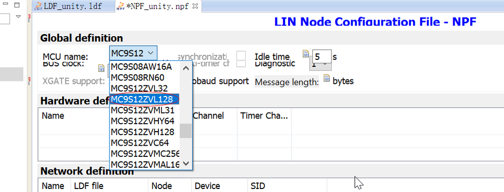

   Why CodeWarrior version 10.6 NPF file creation interface, MCU options without S12ZVLA128,How to add S12ZVLA128 chip to MCU?
-Attached is a screenshot of the MCU options.
Can someone help me,thank you very much.

Hello Jackie lei ,

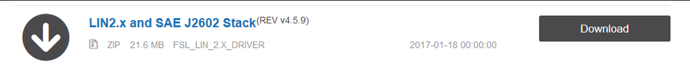

Which LIN stack do you install ? I use the v4.5.9 , it shows MC9S12ZVL128
Download from below link,
S12ZVM Evaluation Board|NXP
Hope it helps,
