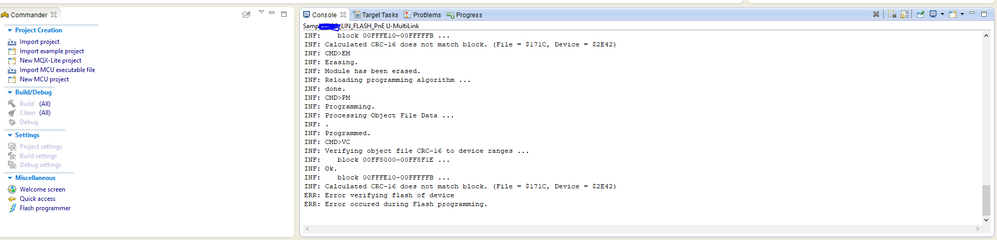

chaitanya_kalyani
Thank you for your response. I got new LDF and now don't have that error.
but while Flashing the program into DEVKIT-ZVL128  getting CRC Error that you can find in below screenshot.
I am getting error only when using processor expert generated code. For without processor expert mode there is no error but I need to use processor expert mode.
I added sample code with processor expert in the attachment.
I am new for LIN and working on urgent project so quick response is appreciated.
4,436 Views
dianabatrlova
Hello Chaitanya,
It seems that there is a conflict with the generated code. I have found a similar issue in the community with the solution.
Please, look at this link:
https://community.nxp.com/message/971435
I believe it helps you.
Diana
4,436 Views
chaitanya_kalyani
Yes you are right. Problem is due to conflict with generated code.
