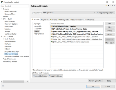

I built a new project under the old directory by using CodeWarrior_V11.1, no warning generated, but when I move the project to a new directory, there is a warning generates:Invalid project path: Include path not found (D:\00760666\Desktop\EbotIO_Board\Project_Headers).What can I do to solve the warning?

Please go to project properties, paths and symbols to make sure the project path setting match the file paths.
For example, this is a Kinetis project path setting:
