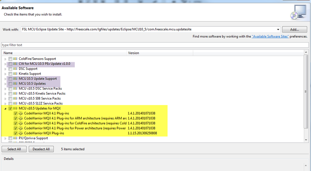

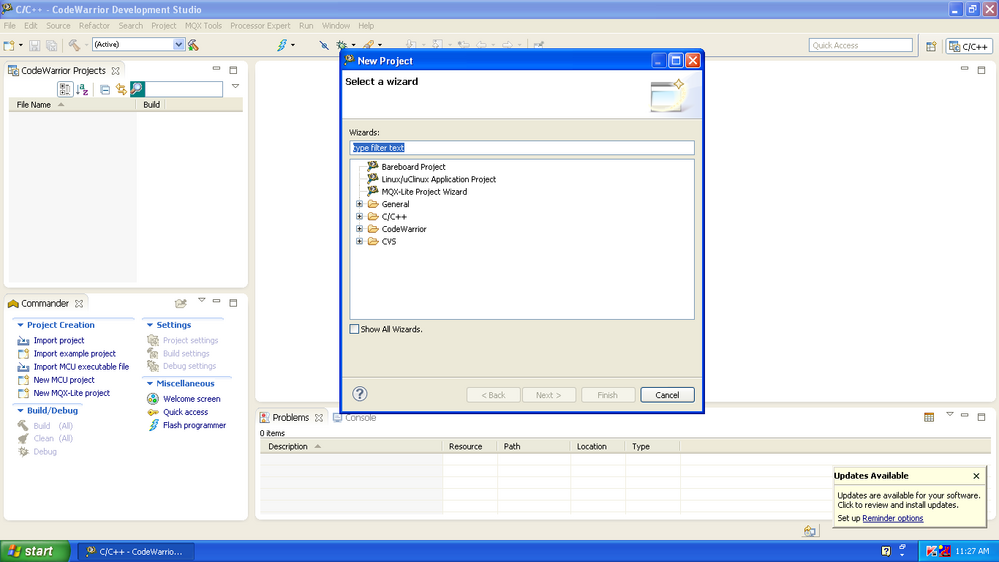

I have installed CW 10.5 and MQX4.1. But not able to create MQX project.

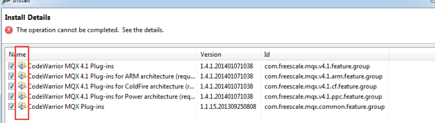

ZhangJennie
from your screenshot, all the five items are color icons which means they are not fully installed
from the error messages, a certain item should be partly installed and has been recorded by CW.
I suggest you fully uninstall CW and remained install.
reinstall CW10.5, then install "MCU v10.5 Updates for MQX", "CW10.5 update". Please pay attention to the install sequence/
at last install MQX4.1.
see how it works?

did you install "MCU v10.5 Updates for MQX" as I highlight below? it's necessary.
Besides I also suggest you install other items I highlighted in purple.
MQX4.1 must be installed AFTER CW10.5 updates installed.
above steps work on many computers for us and customers. please double check.

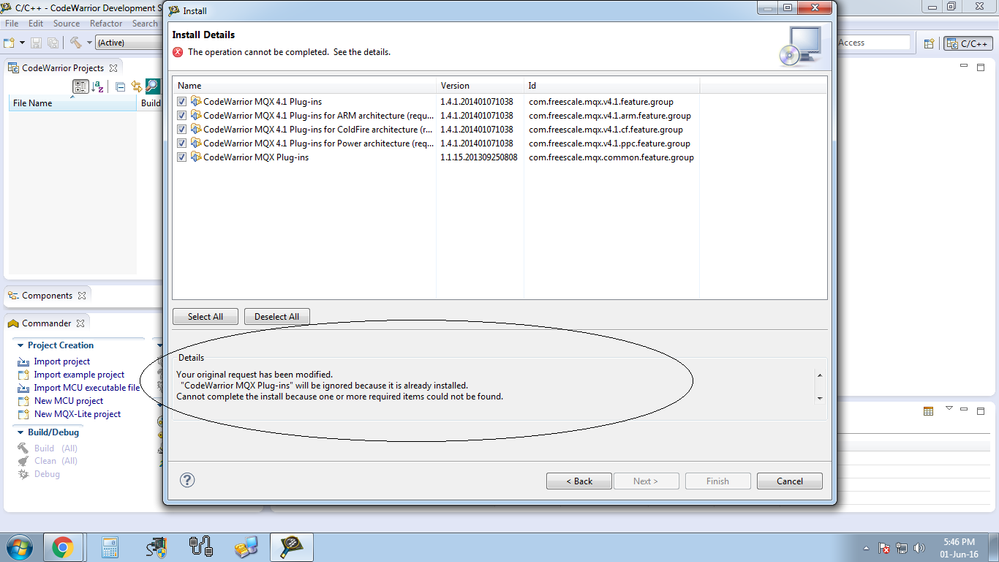

madhukaravs
I installed CW10.5 first
And now i tired to install the updates.
The option which are highlighted in purple, installed without any issue
but  the option highlighted in yellow color, giving issue.
