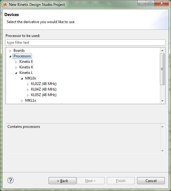

I'm planning a project with the MKL03Z. So I've ordered the FRDM-KL03Z board for testing. The problem is that I can't create a new Project in CodeWarrior 10.4 for the KL03Z-family. There are only the KL02Z, KL04Z and KL05Z available. Is the KL03Z supported?

smartsystems
Hello Mark,
I've downloaded the KDS 2.0 and have installed all updates. But the problem is the same as in CodeWarrior.

Adding new devices to KDS is a two step process: you need to download and install the Kinetis SDK first.
On
http://www.freescale.com/webapp/sps/site/prod_summary.jsp?code=KINETIS_SDK&nodeId=0152101E8C1EF7&fps...
(use 'All downloads' on the right side)
Once you have it installed, use the KDS/Eclipse updater to add the device support with Help > Install New Software. Point it to
C:\Freescale\KSDK_1.0.0-KL03Z\tools\eclipse_update\
and update Eclipse from the zip file there.
Then you have KL03Z support listed:
