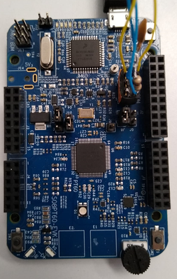

I started work with S08PT60-EVK board without problems to debug. Then, when I changed to MC9S08PT16 and I tried to debug it a "Failed to resume target process. Downloading binary to target..." error start to appear presenting next log:

I tried creating a new empty project and sometimes debug starts correctly but the most of the times presents this error.
Other scenario presented is: I try to start to debug but, in the log I see that it started to loop between different changes of frequencies stopping only closing the IDE showing a log like this:

Actually, I can flash the microcontroller with “Flash File To Target” tool and the firmware looks like it works.
I'm using the S08PT60-EVK's BDM port to flash MC9S08PT16, also I probed with an MULTILINK UNIVERSAL and I obtained same results.
I'm using CodeWarrior for MCU v. 11.1 with last updates.
Also I checked Mask Set Errata for MC9S08PT16 with 0N10J mask (the same that I'm using) and I see the 5264 errata:DBG: Comparator C with TAG type can not generate breakpoint when setting breakpoint at the address other than instruction opcode address, It could be the reason of debug problem?
Thank you.

vicentegomez
the errata only applies to the breakpoints, if you did not set any breakpoint you should not have any problem debugging the device.
Are you using the OSBDM (S08JM60) on the S08PT60-EVK  to program the PT16 in another board?
please that you set all the boards to the same GND.
I do not have the PT16 but if I create a sample for the PT16 using the S08PT60-EVK I do not have a problem debugging it
4,656件の閲覧回数
nlarios
Yes, I probed with the PT16 mounted in other board (a prototype board), with the micro only connected to prove flashing and debug (without other connection) and at least 4 different PT16 microcontrollers. I followed the next connections:
Where J6 is the OSBDM on the S08PT60-EVK board.
I remove only the j5 jumper

Please check also the BKGD pin, you should have data on this pin,
can you test adding a pull up resistor on this pin.
Also can you try with the multilink
I hope this will help you
