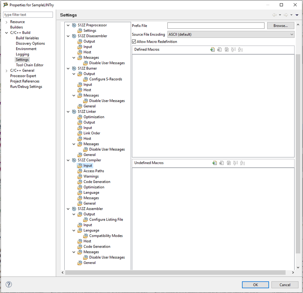

I am facing issue while using LIN stack with processor expert mode.
If directly added LIN stack then getting issue ISR redefined.
If I allow macro redefinition
then not able to flash the program. getting error
After commenting lin_isr.c file able to flash properly. But need a lin signals based on interrupt base.
Can you update the lin_isr.c.  Find sample code that I am trying to use in the attachment below.

Why do you need a Processor Expert? Wouldn't it be easier to set it up by yourself?
LIN uses interrupts that are not generated by the Processor Expert. So, when you don't use lin_isr.c it is working.

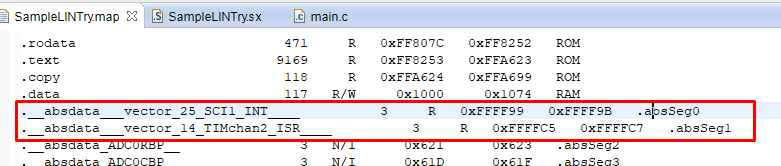

If you look at your .map file you can see below interrupts.
The interrupts can be generated by the init_SCI and init_TIM bean in the Processor Expert.

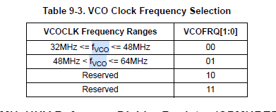

Just not able to set CPMUSYNR register value to 0x8F through PE so setting it manually in main.
Please let me know if I am following any wrong approach and that will cause any problem or not.

It is not possible to set CPMUSYNR to 0x8F because the value of VCOFRQ = 0b10 is reserved.
Please, refer to the below table from the RM rev 2.48

I found the exact issue. The issue was with the baud rate. I added auto baud rate support from NPF and interrupt vector so it is working fine.
But when you update LIN cfg files then need to add #include"IO_Map.h" in lin_hw_cfg.h file.
