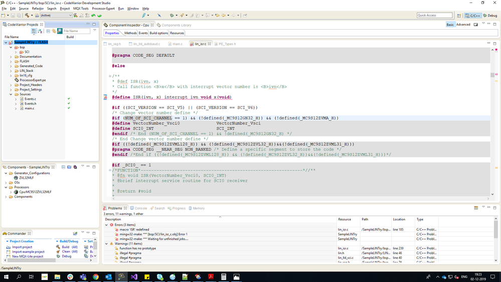

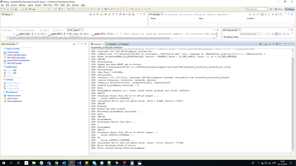

I am facing issue while using LIN stack with processor expert mode.
If directly added LIN stack then getting issue ISR redefined.
If I allow macro redefinition
then not able to flash the program. getting error
After commenting lin_isr.c file able to flash properly. But need a lin signals based on interrupt base.
Can you update the lin_isr.c.  Find sample code that I am trying to use in the attachment below.

Why do you need a Processor Expert? Wouldn't it be easier to set it up by yourself?
LIN uses interrupts that are not generated by the Processor Expert. So, when you don't use lin_isr.c it is working.
As you can see a similar case in this link "Fail to resume target process.Downloading binary to target..."
If you look at your .map file you can see below interrupts.
The interrupts can be generated by the init_SCI and init_TIM bean in the Processor Expert.
