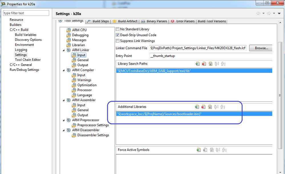

Good afternoon,
I am implementing a bootloader into the microcontroller Kinetis
MKL16Z128 , but I can not add a binary file in memory of my
application.
I'm following the steps in the " MCU_Kinetis_GCC " from page 45
( 14. Include Filename) .
Follows the aqruivo ld I'm changing . See that created a memory
area for the boot and want to add the binary file of the bootloader
in this area.

In this case no compilation error occurs, only not appear the data
of the binary file on my memory map presented in the application
.s19 .
Has anyone done this? Can anyone help me ?
Thanks!!

Please check whether you have added the (.bin) file in Linker Input Settings. Please see the attached screenshot.

tiagoguimaraes
Good Afternoon,
Thanks for you replay.
Already managed to include the binary file. I had performed the procedure you appointed me , but even so the file was not found.
I managed to solve the problem using the inclusion of the path ld file:
SEARCH_DIR("${workspace_loc:/${ProjName}/FLASH/}")
