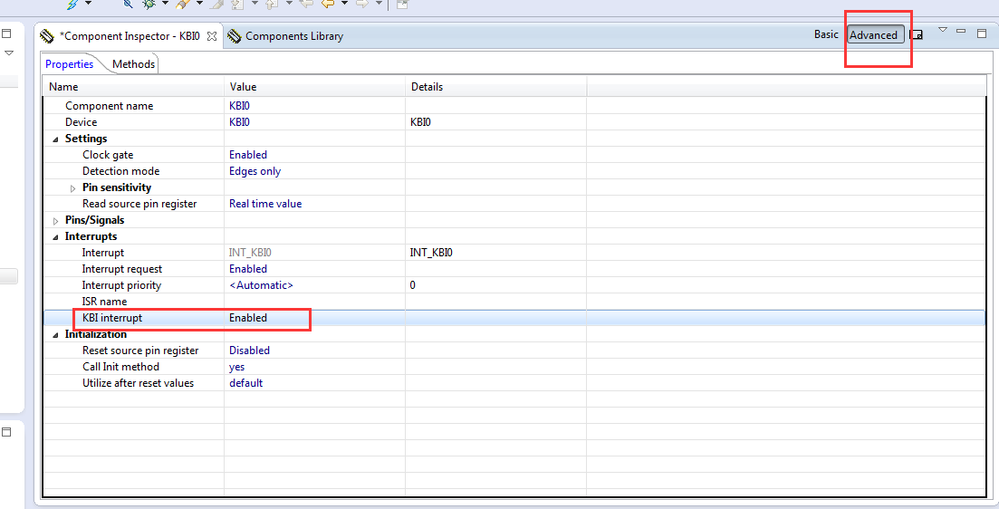

I use CodeWarrior 10.7 with Processor Expert to program KEAZ128, latest components imported. I spent ages trying to figure out KBI configuration using PE, still could not make it. Is there any way to configure keyboard interrupts for KBI pins using PE. Closest I came with PE for KBI was with using Init_KBI, which does not generate the code for interrupt.
I will be very much happy if someone can share an example of KBI using PE, happier if includes pictures too

The point is; Processor Expert does not generate keyboard interrupt functions in Events.c file;KBI not created in Events.c.PNG
as seen above no interrupt functions for KBI is generated. What I do as an alternative; I try to add functions and definitions of KBI manually as in KE02_Test.zip, though I could not have managed to do it without errors so far.

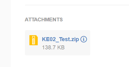

The demo of "KE02_Test.zip " has interrupt :
Hope it helps

Hello Monjen,
There is a sample project using the Init_KBI component :
Kinetis Processor Expert Keyboard Interrupt
in teh David reply :
it is the same with KEA128 , i think you can refer to .
Please pay attention enable interrupt, and choose the the "Advanced" option:
Hope it helps
