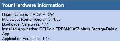

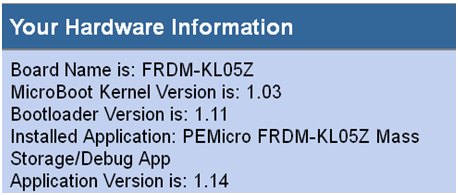

I have 3 FRDM-KL05Z Boards. 2 have been connected to a PC and now have the same problem. I'm not willing to connect the third until I find out what is wrong with the first 2. Here are their version details.
Unit 1: I'd upgraded firmware as per instructions last week.
Unit 2:
Behavior:
When plugged into USB port, the "Found New Hardware Wizard" appeared and searched for and found drivers. This is odd because they were already installed a week ago.
For both units:
Then Windows Explorer opens the drive "FRDM-KL05Z (F:)"
LASTSTAT.TXT contains the word "Ready"
Small green LED on and steady.
When I drop any program file onto it, it appears to program, then I get the program error sequence.
When I enter Bootloader mode, Windows Explorer opens the drive "BOOTLOADER (F:)" as expected.
Small green LED flashing regularly at 1 Hz.
When I drag and drop BOOTUPDATEAPP_Pemicro_v111.SDA to the drive Unit 1 seems to ignore it (maybe because already updated?) while
Unit 2 seems to program, then goes into "Program Error". Unplug and plug. Bootloader version is unchanged.
I attempted to load MSD-DEBUG-FRDM-KL05Z_Pemicro_v114.SDA into both units but get "Program Error".
What has happened to my boards?
