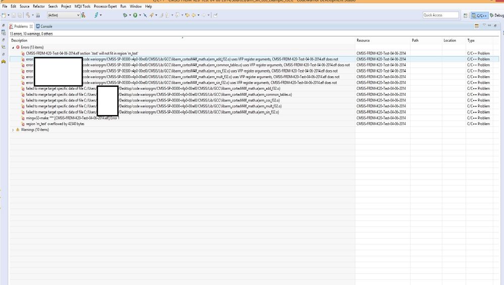

Hi Erich
I am facing an issue while implementing he CMSIS. I followed your blog  upto build and debug I did and after that I am getting 13 errors below is the snapshot
Please have a look . I have attached my test project also. Do I need to use the earlier version of CMSIS library (3.20) or we can resolve the issue in the current lib. i.e (4.00)? I will try with the earlier version and will update the same. Thanks

A couple notes/comments:
1.   Are you using fixed point functions in CMSIS?  or Floating point?.    The code setup in MonkeyJam is 100% fixed point.   You don't have to select any floating point settings.   In your instructions,  there is assumption that one will use the floating point functions and there is no hardware floating point available
2.)   Some of the the cortex M4s have hardware floating point.  Selecting software floating in the setup make CMSIS slow.   The functions will work but there is no acceleration.   If you have an M4 without an FPU,  I would highly recommend using fixed point.   The CMSIS code will use the actually high precision MAC instructions.

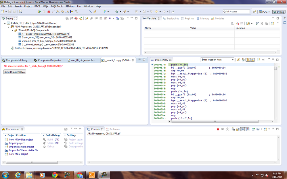

charanreddy
Hi Amit,
I fallowed the steps to interface CMSIS library to Codewarrior from this link,
Tutorial: Using the ARM CMSIS Library | MCU on Eclipse
i am getting an error during Debugging as,
Charan Kumar
10,024 Views
charanreddy
Hi Amit,
Now my program of calculating FFT is working fine. I created new project and fallowed the same steps and it is working fine. I don't know what wrong i did before. Thank you very much for your replay.
