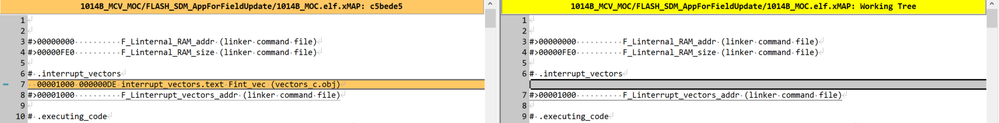

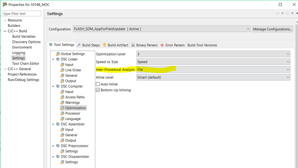

I am using Code Warrior development studio 10.6 for DSC MC56F82478. My flash has been consumed to almost 93% so I made optimization in project settings by turning on Inter-Procedural Analysis from Off to File. This reduced by flash consumption down by roughly 20%.
However the code did not run, so after comparing two elf.xMAP files for both non-optimised and optimised versions, we saw that vector.txt file was left out, which is important for code to run properly.
So I found this file was lying in Vectors.c and I turned off IPA for that specific .c file. This made the vector.txt file to come back again but also the flash size came back to 93%.

 -ipa is only available in commandline mode.
To reduce code size, We normally use size optimization .

We found that vector.c basically handles all the interrupt calls, so when it was cleared during optimization, all the different function called inside ISRs were also removed, which was the reason why so much flash was saved.
