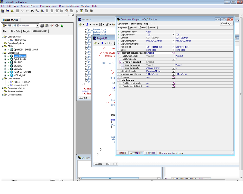

I am using Input capture mode of MC9S12XHZ512 for calculating frequency and duty cycle of square wave from 1KHz to 10KHz , I have attached image of setting i have done in codewarrior.
My problem is that when I try to display frequency on my LCD display I am getting random charter on , I also have problem with interrupt input capture mode I have enable input capture mode in codewarrior , but i'm not able to find it in program , I want to write my display and calculation code in interrupt sub routine of input capture mode. I have posted my code below.
I'm using 16MHz crystal

I've contacted the Processor Expert team.
See below their answer:
The interrupt service routine of Capture component is not directly available for user. When you enable Interrupt service/event of the Capture component the OnCapture event (Cap1_OnCapture) is generated into Event.c program module of your project (see the attached screenshot OnCapture event.png). This event is called from the interrupt service routine that is available (code if generated by Processor Expert) in the Cap1.c program module:
ISR(Cap1_Interrupt)
/* TFLG1: C7F=0,C6F=0,C5F=0,C4F=0,C3F=0,C2F=0,C1F=0,C0F=1 */
TFLG1 = 0x01U; /* Reset interrupt request flag */
Cap1_OnCapture(); /* Invoke user event */
I.e. you can see the the Cap1_OnCapture event (function) is a part of interrupt service routine.
Please, use the Cap1_OnCapture event of the Capture component in your project.
