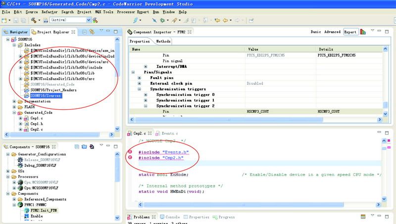

In CW10.5 , how to make the wrong configuration parameters disappear ?

Click on 'Project' menu-> Clean to remove the object file and rebuild again. Can the build tool chain find the head file now?

I have established over the three project, namely for S08MP, DSC56800, kl05, the result is the same.
My computer expert processor 10.2 in once installed , has now been uninstalled , this problem is not and expert processor I have installed a relationship ? Ordinarily should not be , because I 've explicitly set the Header file inlcude path CW10.5 in .

i wonder if you include "generated code" folder to your project.
see this screenshot:
if you include the "generated code " folder but problem still exist, please upload your project here. we will check.
thanks!

Please look carefully at the left shows my red circle , Generated_code already in the list.

ok, please upload your project in zip format here. I need to check it directly.
