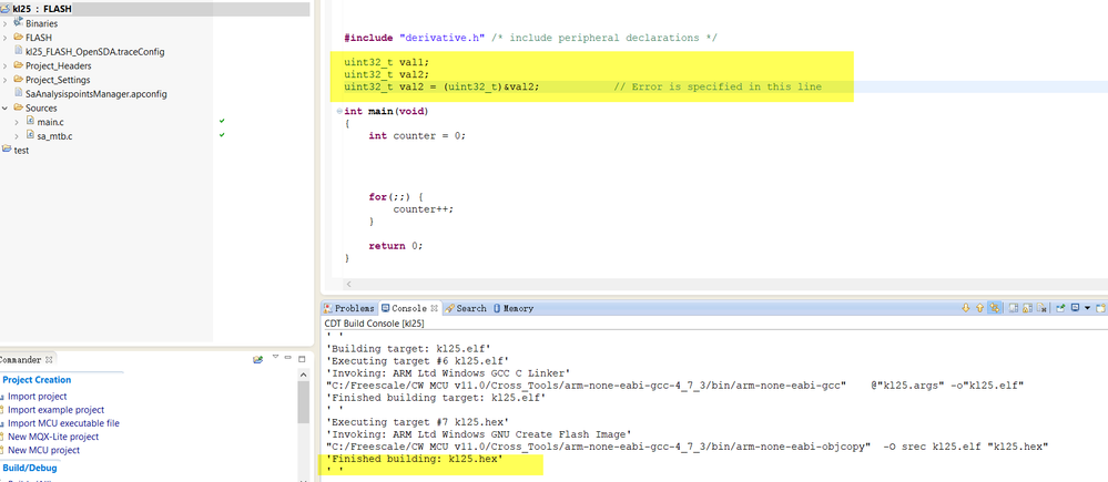

Hello Amit Dhand ,
I test on my side , these code can work well on my side.
Which chip do you used ?
I recommend you create a new project, then copy and paste these code into it , build, check whether can work.
TIC

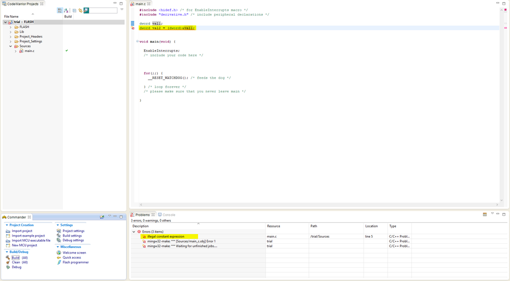

amitdhand
Thanks Alice_Yang for your prompt response on the query.
It is my mistake that I didn't recheck the code before posting. The problem still remains the same
Code:
uint32_t val1;
uint32_t val2 = (uint32_t)&val1;            // Error is specified in this line: Illegal
void main(void)
.   // some code
I am using MC9S12ZVCA192 chip for my project.
Screenshot from the CodeWarrior 10.7
